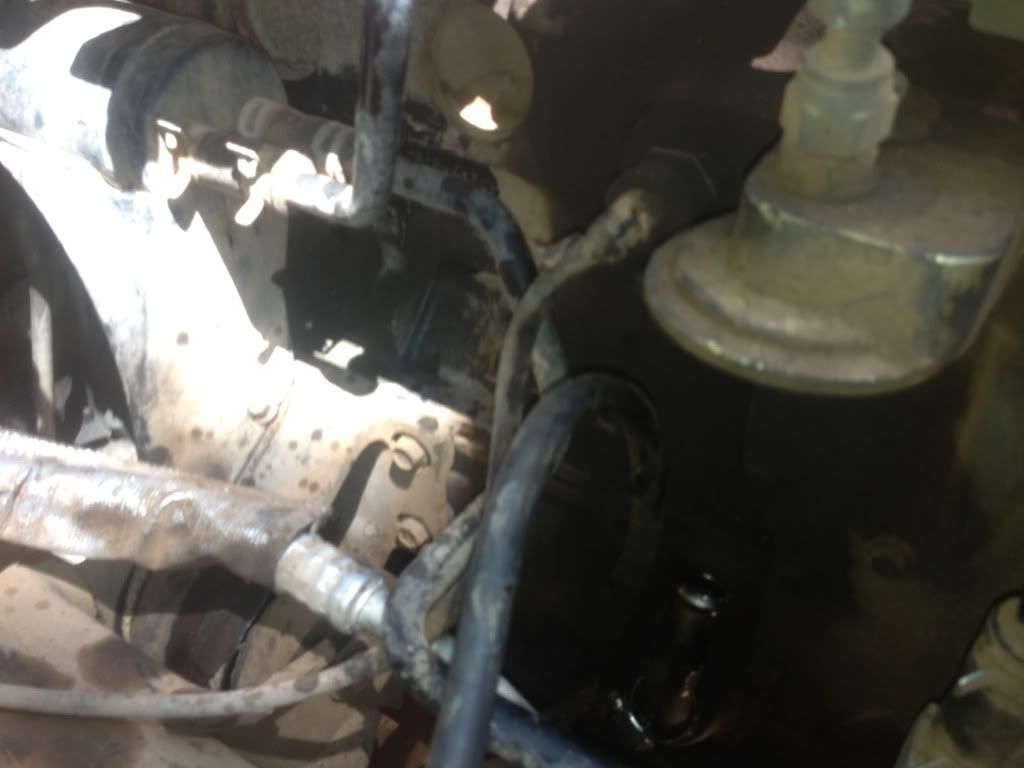

You'll be able to see a stain from the antifreeze below the heat exchanger, but the crack will not be visible. It is always directly behind the heat exchanger.
I don't have the best picture on hand but the heat exchanger is in the upper left of the pic. This is a 53 block with a 12" crack behind there with a failed lock n stitch patch.
Did the lock & stitch work for awhile and then fail? Who did the lock & stitch? Did you install the brace for that area?
