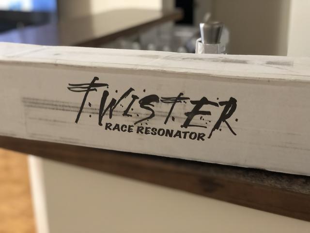

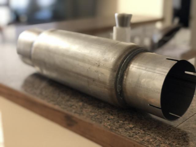

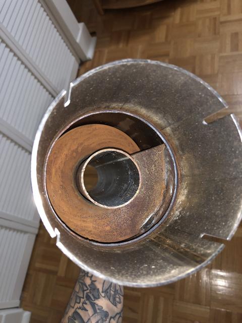

Hey guys, ordered a twister resonator and just received it a couple of days ago.
Just wanted to see if this rust was normal? Found it kind of weird but.. included some other pictures of the packaging and overall piece.

It’s going to turn black after the 1st hour of driving.Must have been humid causing a little bit of surface rust but no big deal. Not S/S that’s for sure. Say goodbye to your Drone.

Awesome, thank you for the response. Getting installed this Tuesday, more then excited !

Where in your exhaust are you planning to place it? Downpipe, midpipe?

It’s recommended to place them as far forward as possible (after downpipe is best)

I wouldn't worry about it. it will be coated after a few min anyway. I agree put it directly after the down pipe is your best place, but depending on transmission might want to move it back just behind that. My 5" is pretty close to the PTO cover on the g56.
