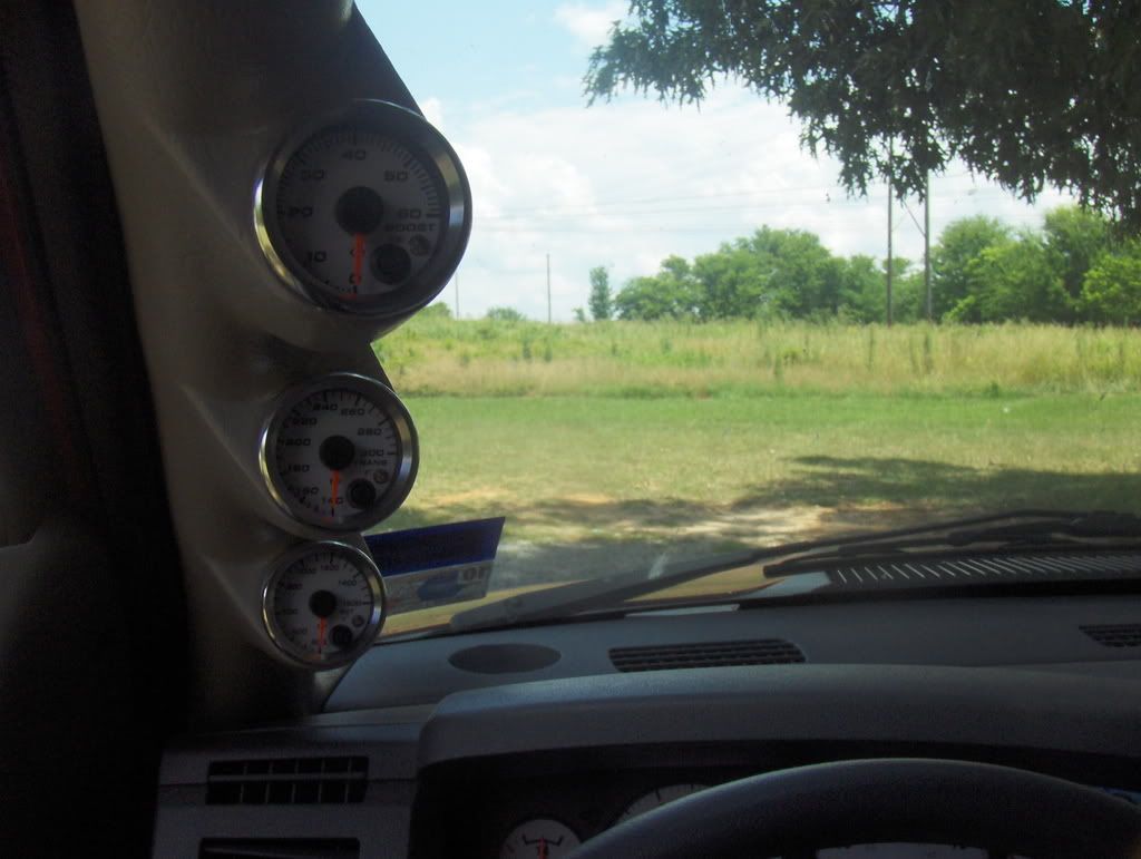

Got my Boost, EGT, and Trans gauges and wanted to see from you guys that have them, should I try to install these myself or is it a pain in the butt? Ive got the gauges in the pod and in the truck, but was trying to figure out if I should try to install the wires myself or should I take it to someone??

Runninpony, those are slick lookin gauges man, what kind are they ?

Speedhut.com is where I got them. Started to make me some crazy custom gauges like you can do on their site but decided to just go plain white face just like the stock gauges are. Looks good without looking like rice,,LOL. Highly recommend these gauges for anyone thats looking, they are very high quality.
