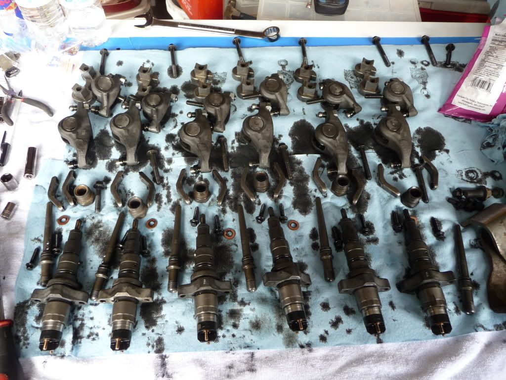

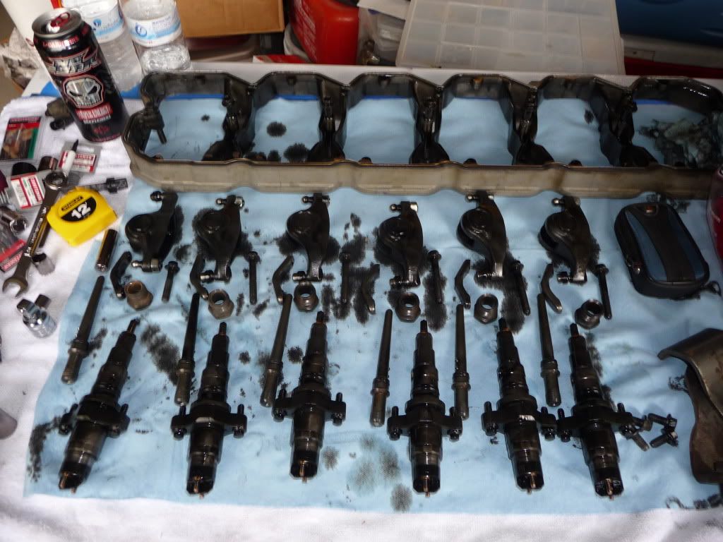

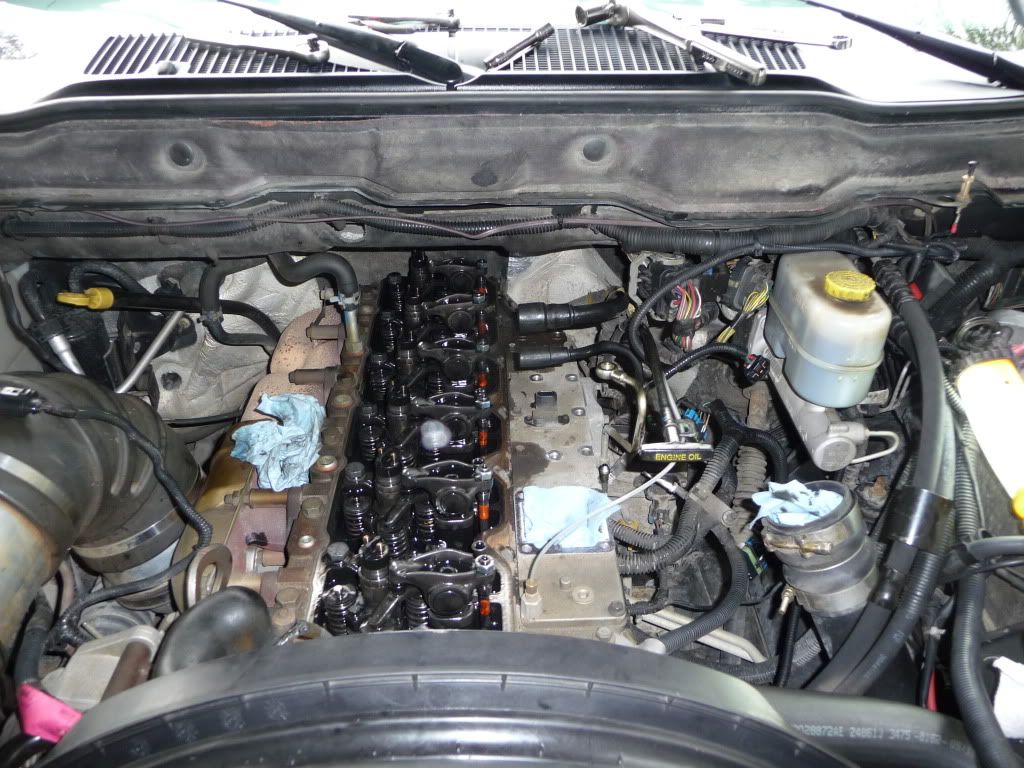

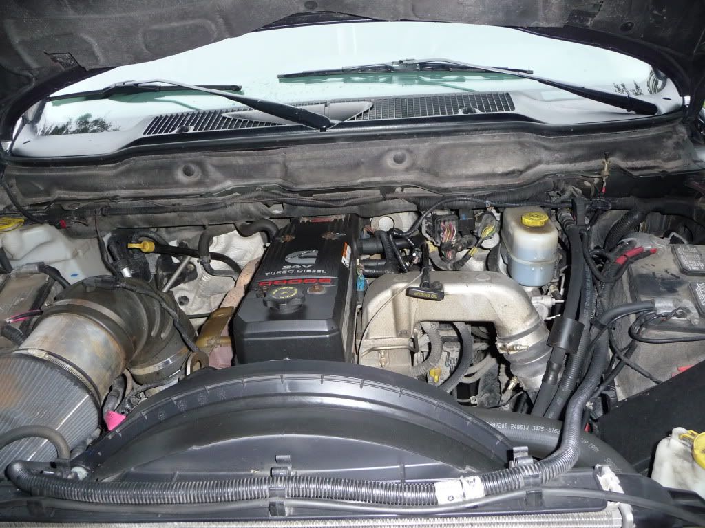

Well, yesterday was the day to tackle the job. Install ARP 625 headstuds, Flux 2s and II 85% pump.
Much much easier then i thought it was goin to be. It really is just nuts and bolts lol. It took me and my buddy 10hrs to install everything. Which i think is pretty good since we are both pretty new at this stuff. Everything went it great, no snags at all!!!
Here are some pics and a video of the first start up. I dont know how people run this much fuel on the stock turbo. With TNT 7 it gets hot quick, I can peg the EGT gauge well before a 1/4mile lol. but I will have more air soon :D

Glad the install went smooth for you. How much different does the truck run with the new parts? Did you check your valves while you were in there?
3,699 Posts
Now we did check the valves since we didnt mess with the adjustments at all. I did notice some improvment, but its just to much fuel for the stock turbo. I wont see the whole benifits from the nozzles until I add air. I am goin with the stocker/s400 setup. then I will really see how much it helps :D

No dude, it wasnt that bad at all. Just did what everyone said and took our time. Yea we only took a couple breaks. While my buddy was doin the studs, I was cleanin the injectors and rockers, then changed the tips over. so by the time the studs where all done, everything else was ready to drop right in.
I did find a tool that was very helpful. Instead of prying on the injector with a screw driver, I bought a brake tool from sears for 5bux, its in the shape of a pry bar just very small. I will post a pic in a day or 2. I thought it was very handy!!
