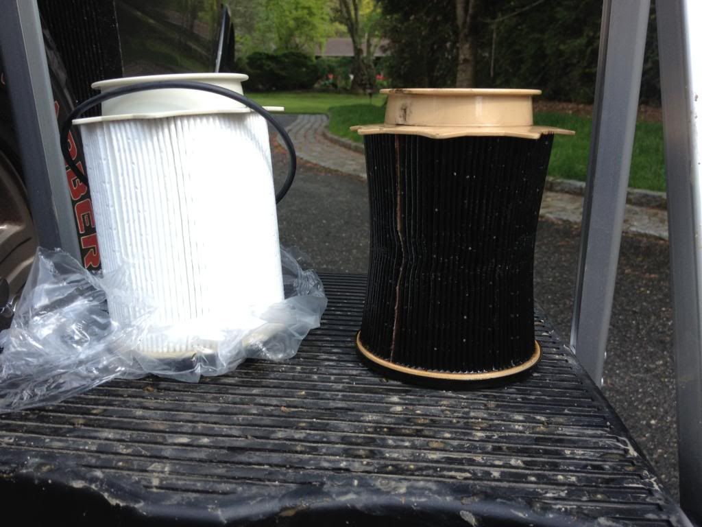

Asphaltenes, ie black filters are from old fuel and fuel that has gotten hot.
If you idel a lot of don't go over 35mph your returing a lot of fuel back to your tank, every pass it makes with out getting burned , exposes it to heat and pressure, which results in the fuel degrading and for Asphaltenes to form.
1,467 Posts
Example of a filter that has seen a good amount of the Asphaltenes.
