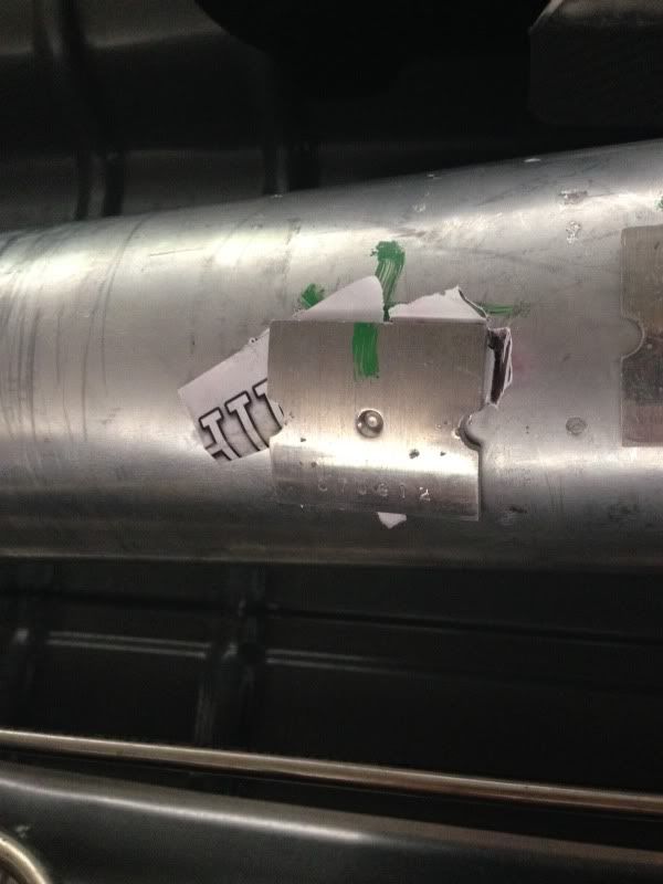

I've been pretty patient. It's started 3 days after I bought it and I've given them 5 months to fined the problem. Have dropped it off 2 different weeks for them to have at it and determine the problem. So far they have taken the rear end gears out and replaced them, ttaken the transmission out and checked it, checked the clutch, and taken the transfer case off and checked it. I told them it was the transfer case they tell me no. lol I've seriously hit bottom on what to do. I've been patient and tried letting them determine what was causing it. They have no answer. They thought it was the weights on the drive shaft hitting the actual shaft. This is what I discovered:

No visible sign of damage. It's all internal. They are at a loss just as me and you are. They have ran out of options. They have done everything they know to do. They put another driveshaft on it back on the 15th of October and by the 23rd it was back to the cracking noise. It does it when I change gears and going from stop to go or when I'm down shifting. Listen towards the end of the video I go from N to 1st then 1st to R and you can here it loud. What has them lost is putting a new drive shaft on it the noise goes away. Something happens from 0-300 miles that causes it to start. I honestly think something is out of line somewhere between the Transmission-transfer case-rear end.
Ah! See you gotta open with that! I took it as it just started in October and you were only a month in! I gotcha...I'd be pissed to.:thumbsup:
And that's some paper of some sort wedged in there?:hehe::doh: There's your "Tier 3" techs (it's just paper on the wall, doesn't mean they're competent).
Has anyone jacked up the rear and put it on jackstands and run it through the gears while someone listens? I'm not saying someone lay under the truck here, that's not safe, but off to the side and tried to narrow down where it's coming from? Has the front shaft seen any love in this process, either replaced or removed to isolate that as a possibility?

My apologies I should have opened with all the details. But When we jack it up.. The sound disappears. And yes that would be torn up Magazine paper. :banghead: But I just received a call from the dealer stating that a "Field Engineer" is going to meet with me Thursday. This should be interesting.
It doesn't sound terrible to me, but perhaps it's worse in person. Putting the material between the weight and the driveshaft was a good way to try to eliminate the possibility that the weights were making the noise. I believe it's something quite minor that they just cannot find.
Also, since it will not do it on the rack, I would check the rear leaf springs. I would blow air between all the leafs to get any dirt/foreign material out. It may sound silly, but that sort of ticking/clicking is a common sound with leaf springs when there is something between them, and it would make sense it goes away when they are not loaded.
