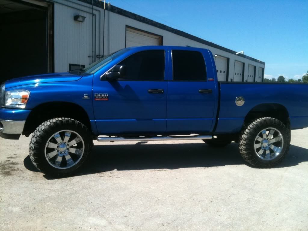

Hey guy looking to upgrade my 4" to a longarm set-up but just cannot decide whether to go for the 8" or stick with the 6". If anyone has pics of there trucks with either a 6 or an 8 that would be appreciated, thanks for your help. Ill put some pictures up of my truck let me know if i should go 6 or 8.

My preference is to not go over 6. To many more issues to deal with at 8 already enough at 6. Driveline issues, clocking t-case, pitman arm and loss of some steering angle possibly, higher cog. Thats just me though. Decide what size tires you want to run then get a lift to fit it.

Is it worth swap out a 4" for a 6" tho. If im goin to all the trouble just go up to 8. I dunno id run a 6 with 37s or an 8 with 38s. Dont wanna go 6 and then wish i went 8

It just comes down to taste. Most of your parts will need to be changed out to go a 6" system. However
Your tires will still look good with a 6"
Your track bar and pitman arm do not get changed
Your shocks probably stay the same height
As stated above a few more components to deal with to make it work
My personal taste is I don't like seeing a quad cab truck past a 6" lift. It's almost like all you see are the wheels. If it was longer it would balance out.

I do agree with u there. Ive seen some 8" that look akward but also have seen some that look really good. Am i gunna notice much of a diff going to a 6?

If you go with a long arm 6" setup you should not notice much of a difference between 4" and 6" of lift. Getting and upgraded/adjustable track bar and combining that with a track bar drop bracket will help with alignment. Also, to get a good ride on any lift over 3" I would highly reccomend long arms. The Carli 6" radius arm system will get you the height, quite components, a great look, and a great ride!

I personally wouldn't go with anything over 6" due to driveline angles without having to use and index ring etc.

As far as height increase am i gunna notice the 2", or will i have to go up to an 8" to noitce a substancial difference. I dont want to have driveline issues. I want a good look but with decent ride and minimal driveline issues.

I was thinkin of 38s on an 8". But ive seen some 8" with 37s that looked perfect.

38's would fill up the wheel well better at the height. As long as you never go off roading in it you would be okay with that big of a tire. I guess I'm used to seeing the wheel well filled up a lot. So seeing a 37" tall tire might look small to me but for you it might be okay..
And why stop and 38 when you can go 39's???? haha

Good Point lol.... But some 6" kits with 37s look stuffed, and have to worry about rubbing while turning when suspension is compressed etc.

All the 6" I've messed with have never rubbed with a 4.5" backspacing of course I never ran anything wider then a 9" wide...
If your digging that look then jump on it. Driving a tall truck everyday can get old but from a 6" to an 8" it may not be any different.

What are you trying to accomplish here? From a 4 to 8 would probably be close to 4 more inches plus another 3/4-1 inches from larger tires. But you will probably have to clock you t-case, have more driveline vibration, blow through u-joints quicker, have less steering angle, need a drop pitman, drop trackbar, longer driveshafts, etc, etc. You will still need some of this with a 6 but not as much or drastic and I would bet it will ride alot better, handle better, and perform better offroad with just a 6 and some good meats on long arms. Keep the lift low with enough flex and room for meats it will perform better.
Just my $.02
