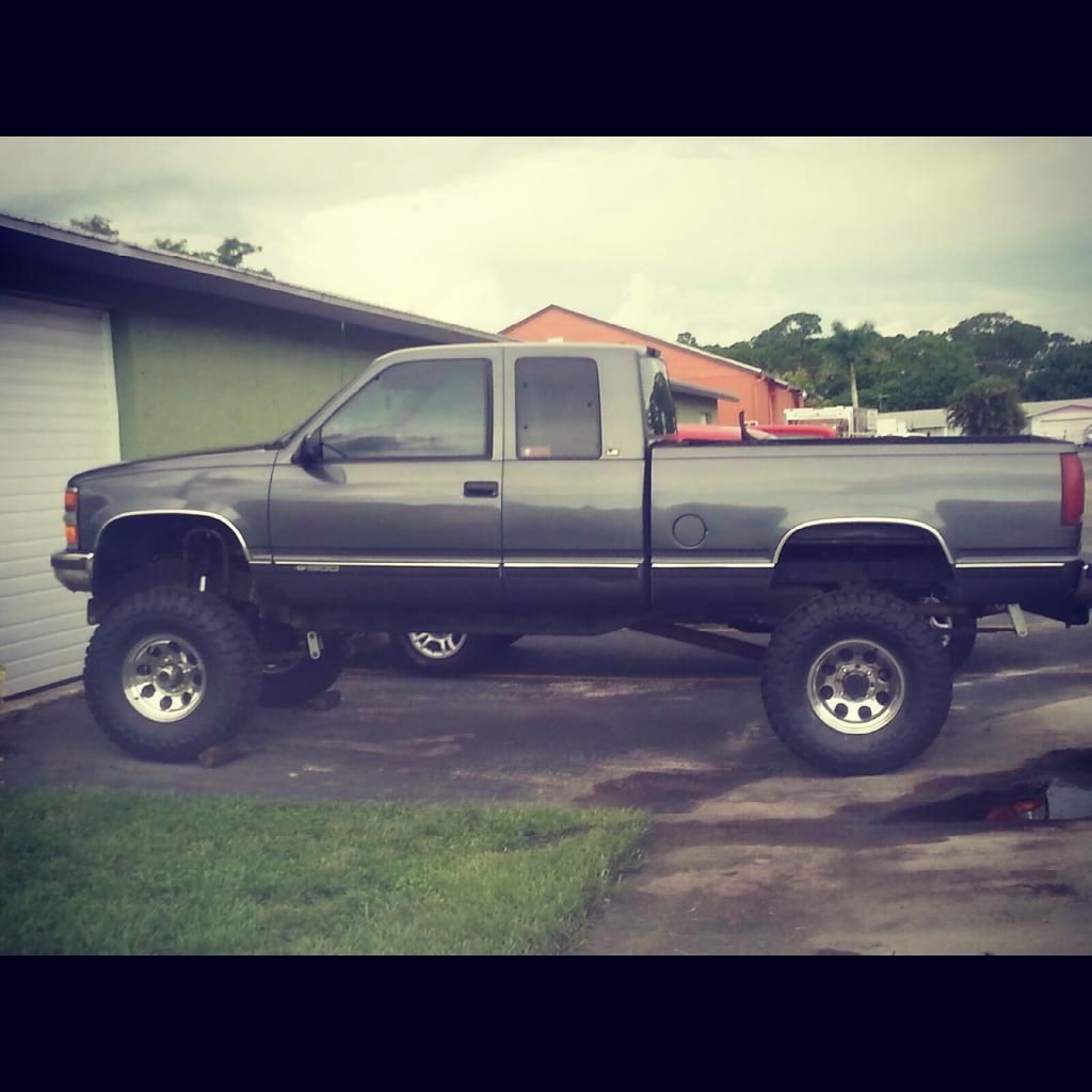

^ that is how she currently sits. next thing that needs to be done is traction bars, then get started on the cummins swap

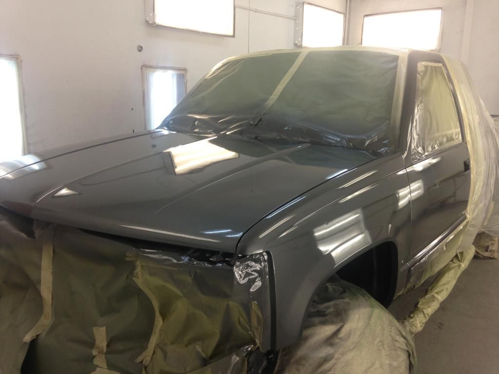

right now the front has k5 blazer rear springs in the front. on average the front will drop about 1 to 2 inches. from what i have read if it only drops an inch i can do an add a leaf and its good to go. if it drops 2 or more then going to have to run k10 or k20 rear springs in the front with an add a leaf and that should level it out. if all else fails i will get a bit longer shackles. and yeah i hate that also. but i used to work for a body shop and i bought this truck wrecked and fixed it up. took about a week to make it look new.
