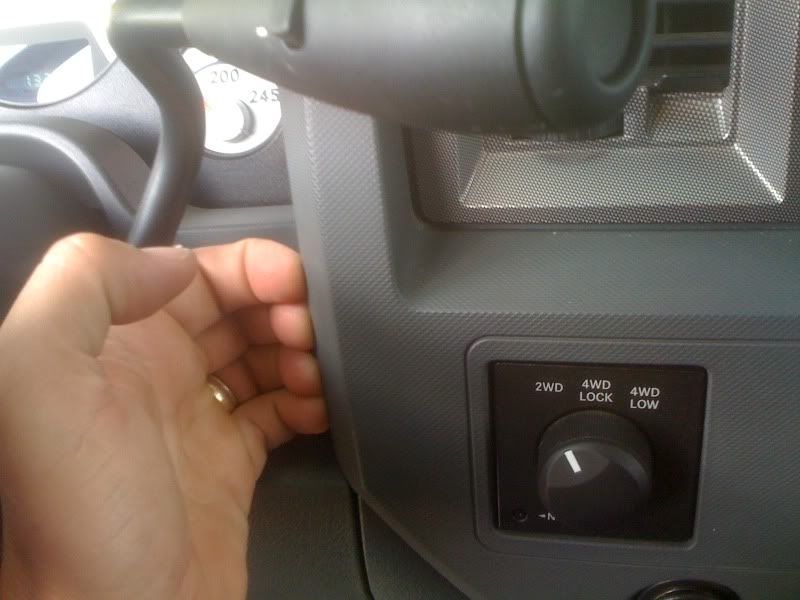

Yes, the radio bezel just pops off. Best place to start I found was the upper right near the gauges. Use a plastic trim tool and pry it off. (Like the ones you get thru Harbor Freight) Some guys say they use their fingernails, but that thing is on there pretty tight. Once you get it started, just walk it around. Goes easy after the initial start. I wouldnt use anything metal as it may ding up or scratch the plastics.

You can also take off the triangular piece on the side of the dash, If you don't have power petals, you can use the power source for those, that's where I got the power for my gauges.
