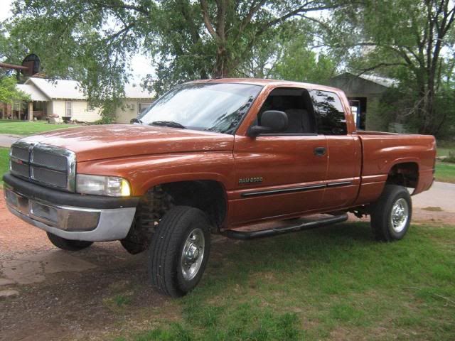

Well I wasn't really shopping for another truck but my father called me and told me he knew where there was a heck of a deal on a 01 cummins so of course I had to go look and ended up bringin er home. I'm not a fan of auto but heck like I say the deal was so good I couldnt pass. The truck has 217,xxx on it and is tight as heck. I have quite a few plans for this truck and it may turn into my dayly driver. Also I have a question, I'm sure there is a post on this somewhere but I'ma go ahead and ask. The steering is a little odd. When I turn it it feels like something is tight :confused013: once I turn the wheel I have to kinda pull it back to center??? Anyone know what could be causing this? Anyway here she is.

Looks good, really digging that color.

Ya I'm kinda fond of it. I'ma black it out I think.

Cool color, looks pretty clean. Put some more aggressive tires under there and then it will really come alive and as for your steering problem maybe the power steering is going out, it’s what it sounds like to me or it could be a lot of other things too. Not real sure what you mean when you say "something is tight."
