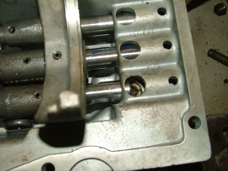

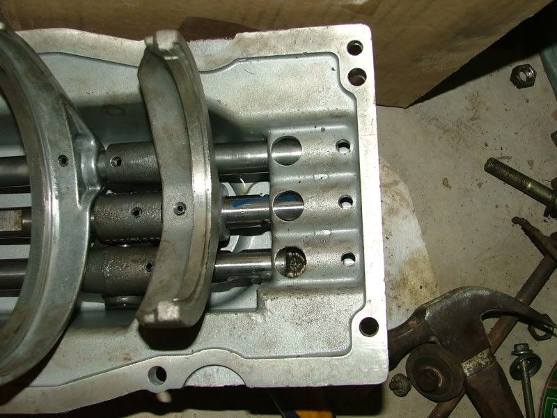

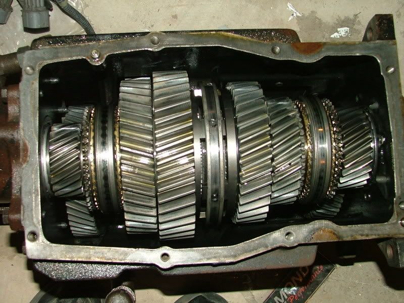

So i tried this in the oldy section and no one noes the answer. I was driving my truck and the shifter went free flowing everywhere. SO i pulled over. trailerd her home. Pulled trans. Opened her up and the rod on the 5th and reverse came out popped freeze plug. and the black pin that holds shift fork is MIA. So i think that may have been the problem. So i went to put it back but there is a ball joint in the hole that wont let the rod go by. anyone no what the problem is? heres some pics

5th gear to reverse gear lockout? Clear by going center (or what would be center) stick then retry. Sorry...thats all I got man
