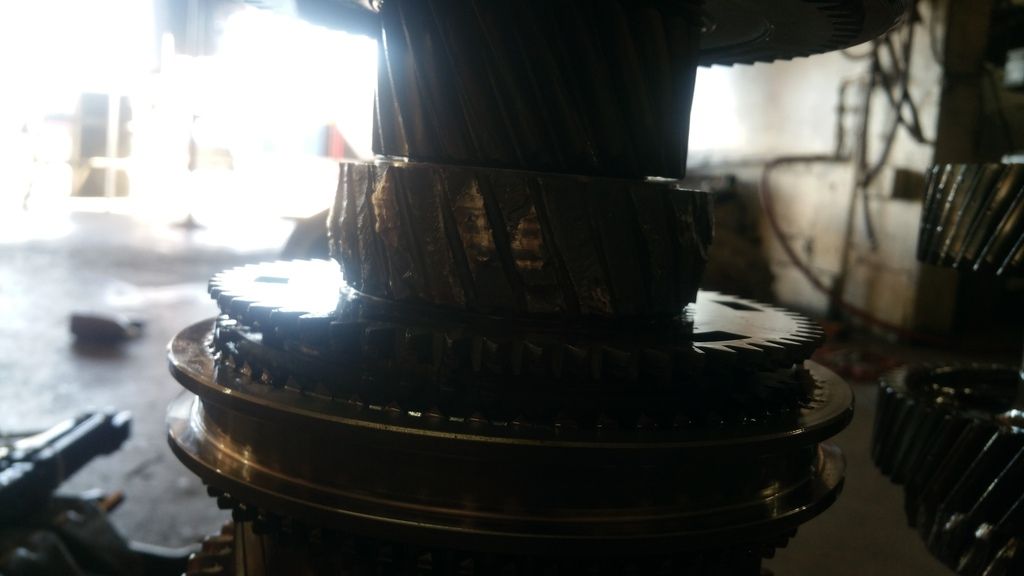

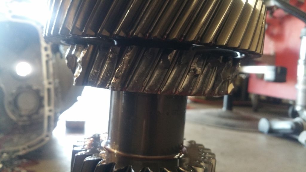

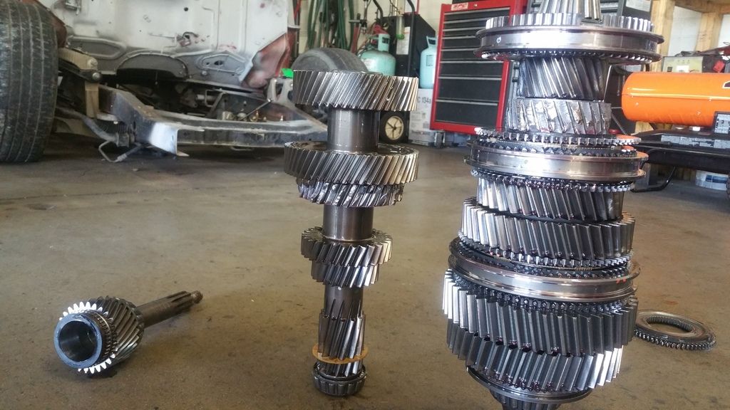

Spinning pretty hard in 4th the other day and she caught some traction. Finally had some time to tear it apart today, this is the outcome

I dont not believe the gears can just be replaced. I think the whole main shaft would need to be bought,

The Mopar parts catalog shows the gears on the input shaft and main shaft are all available individually (although it appears that the front gear on the input shaft is part of the shaft itself).
But you are correct regarding the countershaft; it is apparently only available as a complete kit, with the shaft and all four gears.
Maybe a junkyard trans would be the best bet.

Countershaft cluster gears are available in sets.
3-4: Dodge RAM 2500 3500 G56 6 7L 6 Speed 3rd 4th Gear Cluster Transmission 2005 5 9 | eBay
5-6: Dodge G56 6 Speed Transmission 5 6 Press Gear G56 9A | eBay
