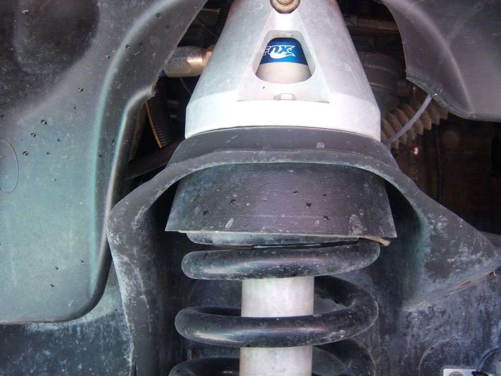

idk but i think its to fill them with air...i will take some pics and then post them in a couple minutes

here are the shocks......
was wondering if i could fill the litttle tabs on the end with air?
i don't think those are air shocks. i agree with jfranklin that those are most likely nitrogen shocks.
ok well at least now i know lol
Do not put air in them. They are nitrogen fill only. The pressure should be 200 psi on all four corners and the front S/S you can play w/ the pressure. The more the better, but sometimes the truck will pull left w/ higher pressures. Just let a little nitrogen out until it tracks straight, but still feel the S/S work.
Are you sure those are 3.0 shocks? Did you get the truck used since you said "I believe they are 3.0 shocks"? They look like 2.5" shocks.
when i got the truck, the lift was on, but with stock wheels and tires!?!?!? maybe the previous owner took them off but i dont know. thanks for all the info. but where would i find a place to fill 'em up with nitrogen?
The schraeder valve is to charge the shock with nitrogen. I'd fill with 150 psi minimum but you can go much higher than that. I think we put 250 psi in my Kings last time around, and I know people who run 300+ in their shocks.
Have them filled at a motorcycle shop or even a welding supply.
