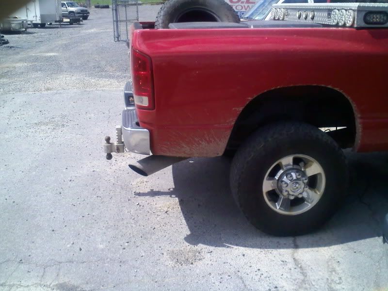

I have the H&S exhaust and this is how it exits on mine. This is the Expandit kit.
