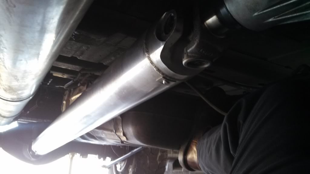

The truck has no vibrations at all when driving but i did stick my head underneath to take a look at the drive shafts due to the fact that the angles were drastically changed. I looked at the rear drive shaft and first thing i saw was this
This is by the transfer case, i believe its called the slip yoke? excuse my lack of knowledge. I never really looked at it when the truck was stock but i do not think it should be sticking out that far, the wear marks kinda show that it should be in farther then it is. Anyhow my main concern is whether this is safe or not? Last thing i want is to cause damage to the truck. :confused013:

Looks like you could use longer shafts front and rear. Its common when you lift a vehicle

well yeah but there are plenty of others running an 8" with no issues... My truck makes no noises either. How long is that slip yoke? Take a look at yours does it look the same? Maybe ill just take it to a drivetrain specialty shop and have them tell me what they think.
I don't know about this particular truck, but when doing a lift, usually you rotate the axle so it is more in line with driveshaft angle. This will alleviate a little of the length issue.
I would not worry about the rear drive shaft that looks about normal. Yes its moved a little bit back but that's do to the added distance. I lifted a few dodges in my life and my 08 was 12" lift in the back and there was still plenty of slip yoke left. I never measured but its like 8" to 10" long :hehe:( that's what she said). That 2" is nothing to worry about. Now the front that's a different story on my 08 I ran 8" rize and 2" spacer on that in the front and used the stock front shaft worked fine. How ever on my 12 I have 6" carli and they said to add 2" to the front drive shaft so I did. :confused013:

thanks for the input guys! spoke to a local guy who's got the same setup with 2" spacers in the front (2" higher), he clocked his T-case and is getting his front shaft lengthened. I'll take a trip to the powertrain shop and see how much it will be to have my front driveshaft extended this monday.
