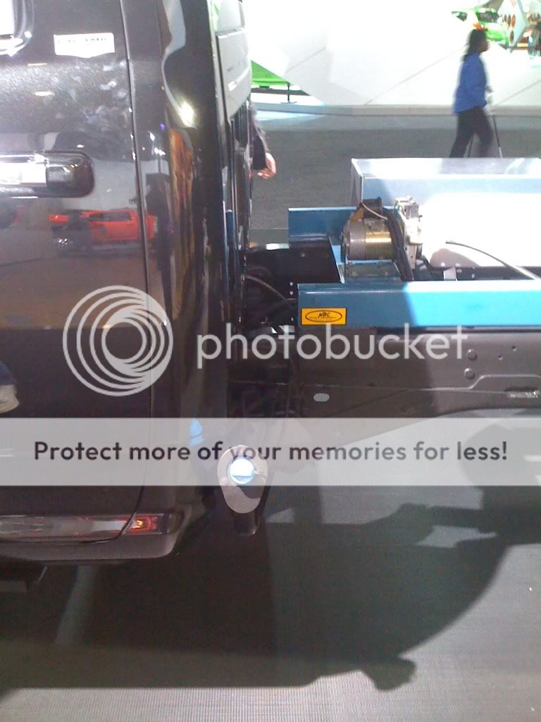

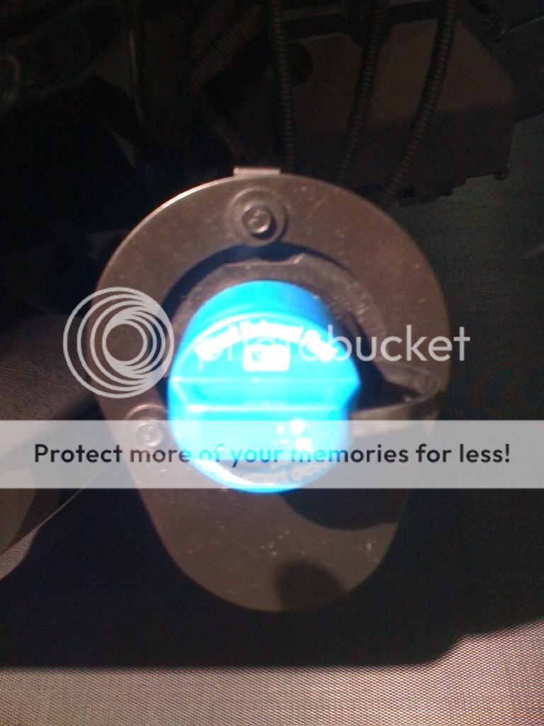

Well, I have to say this is the first 6.7 that I've seen that has a filler for the Diesel Exhaust Fluid or urea. Couldn't find any one at the auto show that could answer my questions about how often you have to fill it up and if I could do it myself. Just though I would share the pictures I took. Should have taken pictures of the truck because It was pretty cool.

If I remember correctly, it takes about 15 gals every 15K miles; it's only used on the cab & chassis models; it's available at most major truck stops; a few places have a small dispenser next to the diesel fuel "pump" but most have one or three gallon sized jugs; and it costs "about" the same per gallon as diesel fuel. YMMV! And yes, they put that pretty blue filler in a convenient location so you could do it yourself.
What's all that stuff on the back of the truck?
