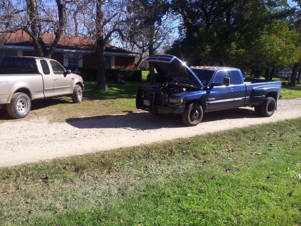

This is my first injector change I've done on a truck and overall it went very smooth. It took me 4hrs start to finish. It was only around 40 out that's freezing for me, I wasn't in a hurry cuz I usually drop stuff and have a bad habit of not being able to find it...
I put in DAP 7x.010 SAC's heres some pics
It cranked up easy for only cracking two lines
Free Rev smoke was none had me a lil worried at first but after driving back to town I had no more worries
First impression is Wow! I drive like my lil grandma with a very light foot and it feels way better than my other 2 2nd gens that were tapped
Even with such a light foot I could tell a huge difference. My truck now going 70 is about equivalent feeling of driving in 2nd from before! Lol
I dont have a Pyro or boost in this truck so I cant comment on that
I do owe a big thanks to DAP and also Casey! any questions and concerns I had he didn't mind helping me out
