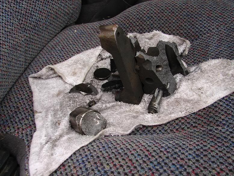

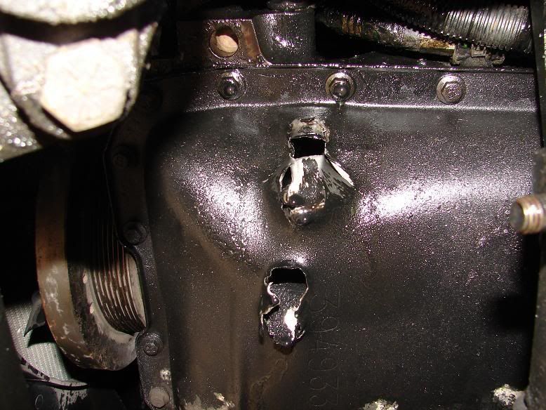

Well leaving a Chili's last night cruisin through the parking lot, shifted into 3rd gear about 1100 rpms heard a loud kaBOOOOM, then the sound of metal shattering and lots of coolant and fuel and oil hitting the ground. I have a piece of the cam and a piece of the driver side of the block..
The Block has a new Window - No its not a double pane... LOL.

My old VP44 Had been leaking fuel into the timing cover, for god knows how long. Well i went to go start it about 3 weeks or so ago and it wouldnt turn over, so i checked my batteries, checked the oil and BAM - Fuel on the dipstick. So i drain the oil, put fresh oil in - fires up runs like crap. Diagnose it and the front seal on the VP44 failed, Thus dumping fuel into the timing cover
So our theory is that all those thousands of miles it was trickling or dumping fuel into the oil reaked havoc on all the bearings in the motor and finally one of the bearings seized. Probably the cam seeing how its shatterd ? LOL
Who knows. But gonna rebuild it better then before. Probably Stud the rods and mains,Big cam and put a 3rd gen block in her. She'll be better then ever..:peelout
