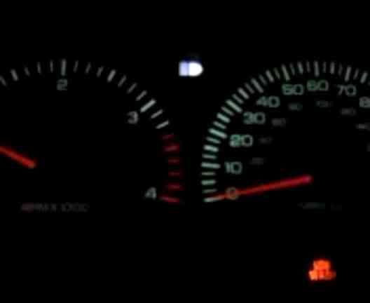

Vids:

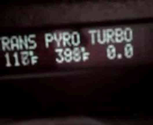

Vid of my gages and then speedo on 0-100 with duration on 1
Tranny is my goerend with about 100K on it. Still hitting gears hard. You can see all the shifts even when the TC locks up. :)

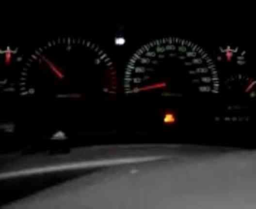

This one was a botched attempt. Guess I hit a slick spot. Broke the tires loose and went sideways. LOL
These are in Phoenix, duration up to 4 timing down to 3. Engine light is on from just reprogramming w/ smarty

looks like a winner man! is your pyro pre or post turbo?
Pre turbo close to the flange, in the back turndown. :thumbsup:

Man that thing hits at 1800rpms don't it!! lol That thing goes real good!! Be interested to see what egts were like with a edge or quadzilla... Probably a bit higher. Nice ride for sure tho!!!!
Yea thanks guys. Also if you notice, I did the run from idle to WOT. Not the best but its makes it more repeatable. Guess the TC only flashes to 1300ish. One of Goerends earlier converters. Seems he has slightly higher stall ones now. I have read lower stalls seem to lag more and this still isnt bad. Good spool, and clean. I like this spool and this is coming from a HY. The turbo that spools before ya hit the throttle. :hehe:
