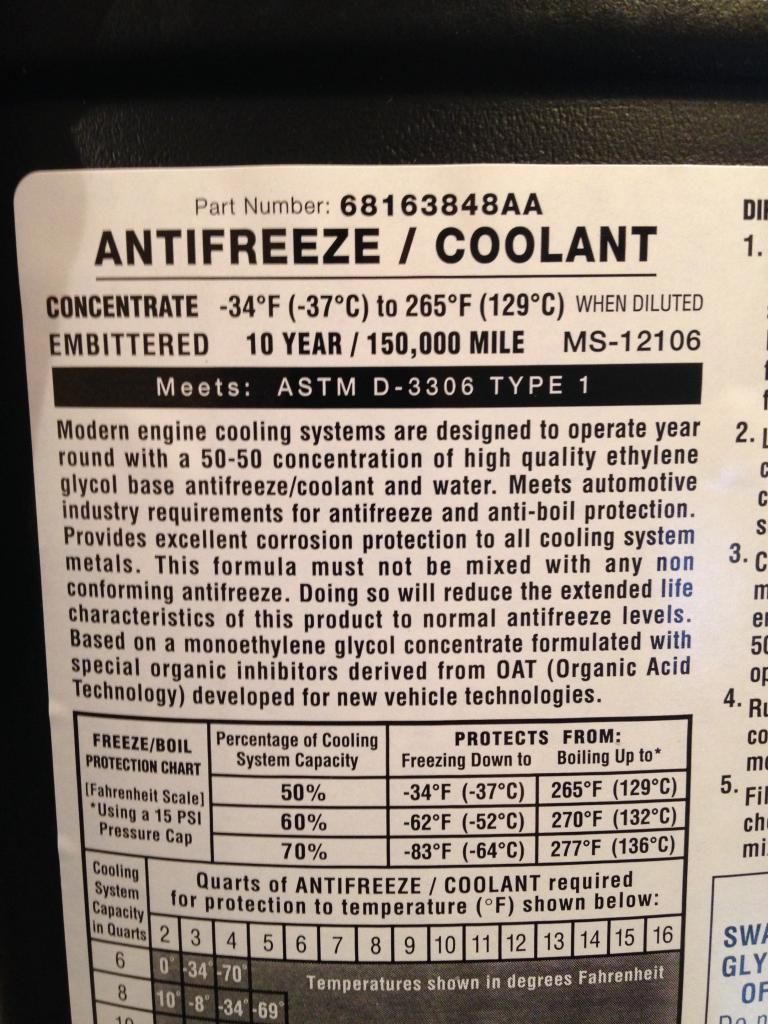

im all confused as well. I have a 2013 3500. looking at the coolant in the bottle it looks orange. the dealership gave me the purple stuff. i added it, haven’t noticed any issue. i hope my truck didn’t get the orange stuff from the factory:doh:

here is the coolant that I was given and used to top off my truck. it is the MS-12106 spec that my truck calls for. it also says OAT right on the label on the back. the top of the reservoir bottle has a sticker on it that says MS-12106
i am relieved, i got the right stuff. i mixed it 50/50 with distilled h2o
