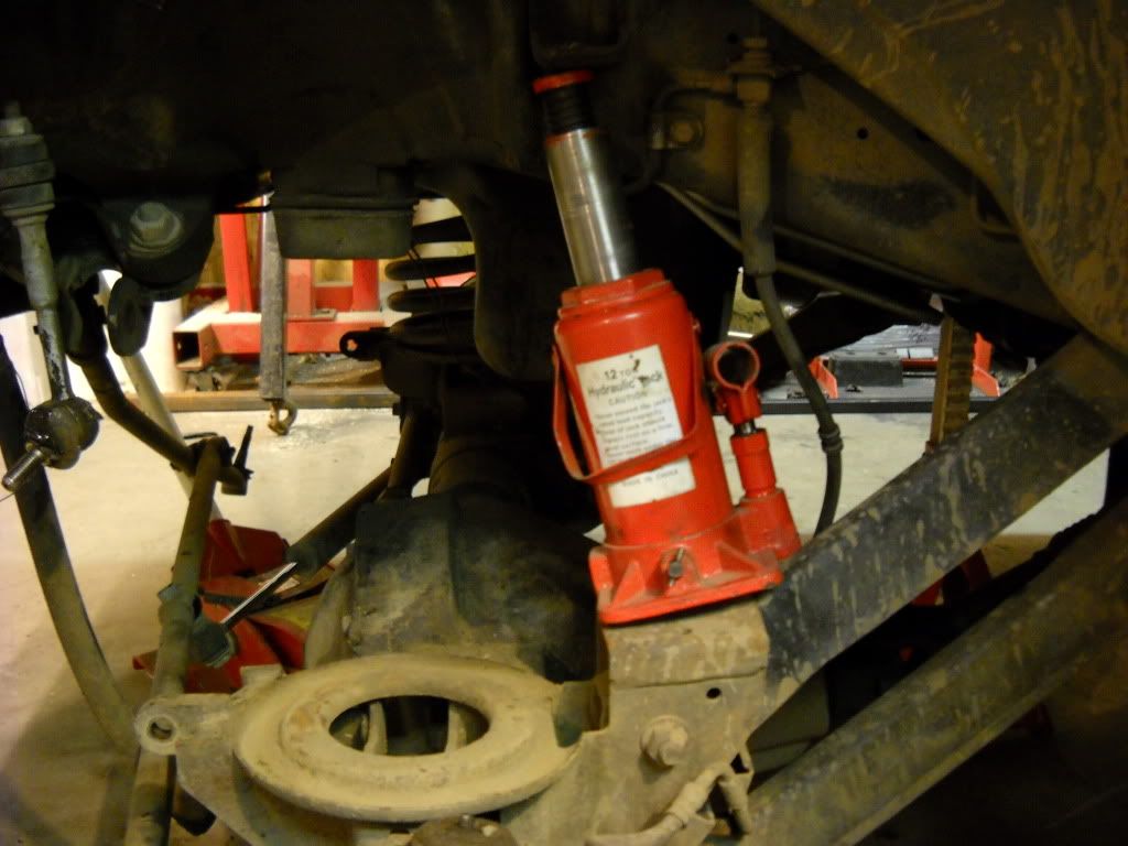

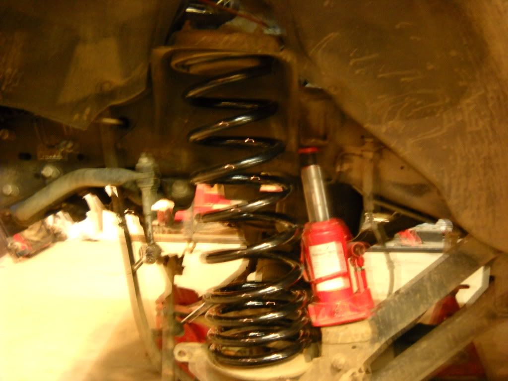

took out my stock springs and installed carli springs, never need a compressor, jacked truck high, axel stands on frame, unhooked shocks, pass side tie rod/ unhooked one end of track bar, removed wheels, lowered axel to the ground springs fell out, installing the carlis had to jack the axel down farther but they did pop right in
jacked down like so
