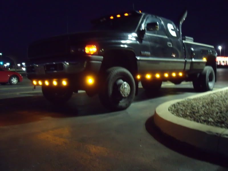

yes, that's the look i'm goin for...:thumbsup: :hail::hail::hail: :hail::hail::hail:
course, i have a ranch hand, and i'm a SRW and, have 35 inch tires...:D

Its pretty straight forward. Not sure what kind of plugs your lights have. It's easiest to run them in series. First mount all you lights. Then on one end of the series find a good grd. Then run a wire light to light. On the last one run the wire up to rather your fuse block under the hood or to your headlight switch. The wiring that comes out of fuse block is a huge ball of wires. But not to hard to find the running light wire. I've got pictures of mine when I wired in a interupter swith.

It sounds like you were on the right track. If you tap into the wire after the fuse block you should hurt anything. What ever you do make sure you use shrink wrap on all the connectors or you'll be pullin your hair out tryin to fight little green monsters every where. Heres a pic I took when I did my switch.
