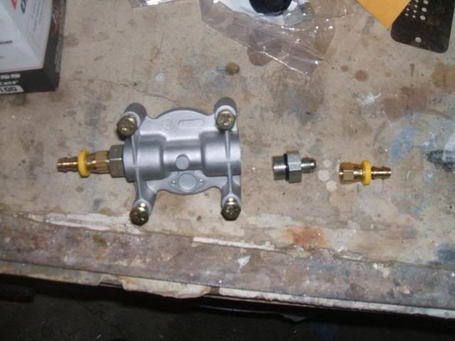

Ok so it started with a baldwin FB1311 fuel filter base. Then I used a o-ring JIC #10 to 6 fitting with the 3/8th adapter.
