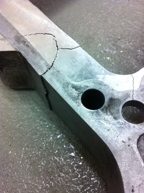

The timing case is cracked due to the previous owner never taking care of the KDP. How often do people REPAIR the timing cases? I haven't heard of anyone repairing them, just replacing.

I'd say fix it, if they own a machine shop, just make sure it's true flat for a good seal.

That was my MAIN concern.. That it's 100% true flat. I might use a silicone sealant for back up :)
How come I never hear of them being repaired.. :confused013:

You never hear about them being fixed because once you have invested all the time and effort to get the broken gear housing off, it's only about $250 to buy a new one. A machine shop would cost alot more to fix an old one. But since you know people....

if you know someone that can do it cheap/free go for it. worst case scenario it breaks and you get to do it all over again and hopefully you dont wipe out anything else!
My biggest concern is how badly that thing fractured and the forces involved here. The injection pump eats easily 50hp, it would suck to pop that thing apart when your in the middle of nowhere.
Personally, i wouldnt bother f'n with it, search for a used one. IIRC a new one runs ~500 from cummins, so thats probably not an option for you

As long as the case isn't cast, it appears repairable. Once that's done, stick it in the lathe or CNC and resurface to ensure it seals properly. Having a hookup at a shop will help greatly. Any work I need done on a lathe, end mill, CNC, five axis CNC, etc...I just have to help a little and provide beer.

they are cast... but thats not a huge concern, working with cast aluminum is not nearly as bad as iron!

Thanks, I wasn't certain if they were cast or not. It will make it a little more difficult, but it's still doable. Like Dave said, cast iron is not an easy repair.

I had mine welded, holding with no problems

I had the gear case TIG'd back together.. It turned out great! After he finished welding, all I had to do was clean it up .. Didn't take but 10 minutes :thumbsup:
Free TIG welding :party018:
Before:
After:
Got it true and cleaned up for the most part.
