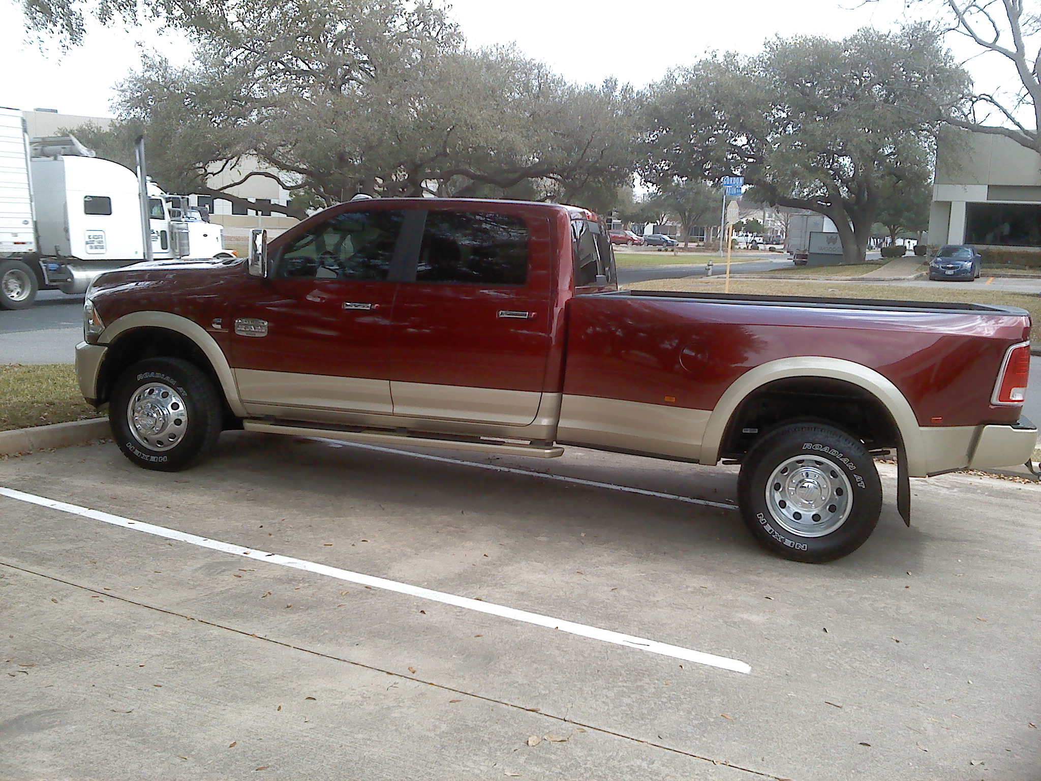

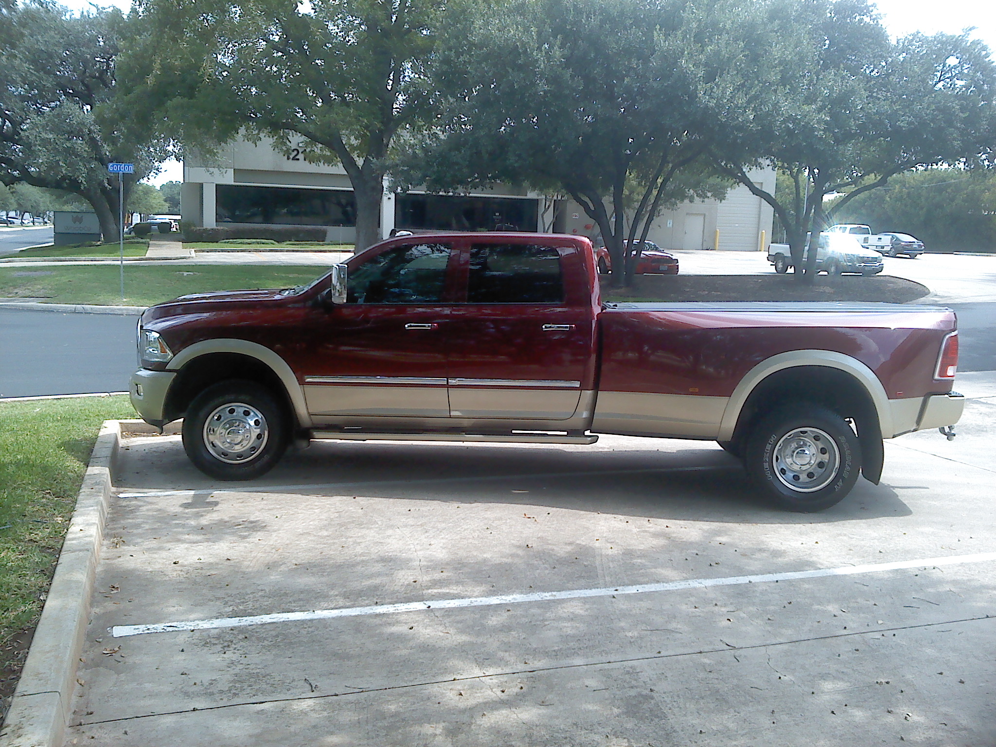

Mine was all wrinkled around the edges and cracking with a thousand miles on the truck. I think pulling off that crap was the very first thing I did. Before and after:
It was cake to pull off.... But the truck had been sitting out all day on a July day in San Antonio. Peeled right off. WD40 wiped the glue residue away. IIRC the hardest part was removing a little screw at a bottom corner to get the last little bit.

That looks great. I have a heat gun, I might go do this tonight if the kids go down easy/early haha.
Thank you. Yeah, it would be a different story of the blackout were shiny. Then it would blend with a dark tint and look like it's supposed to. But flat/matte ... it just stands out like a sore thumb, IMHO.
