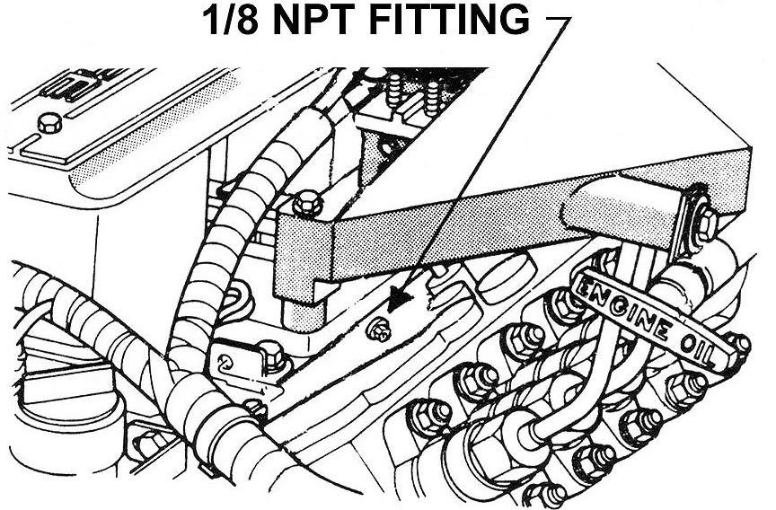

Where's the best place to get boost signal on the 12 valve ?
