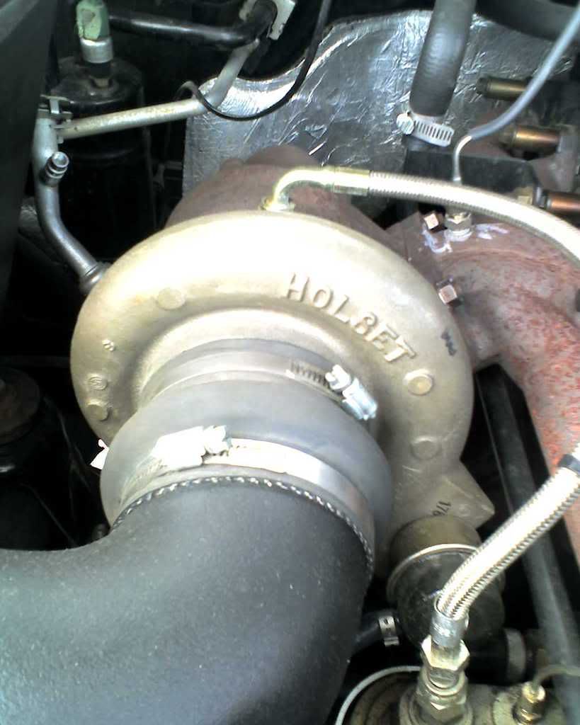

Here is a pic of my turbo, maybe somebody can tell me if it takes one or not. Now I am not sure.
Yes it will work on that turbo.
Beware of overboost code if you dont have a boost fooler or chip to fool. You could get a P0234 if you boost more than say 22#!!!!!!!!!!m
