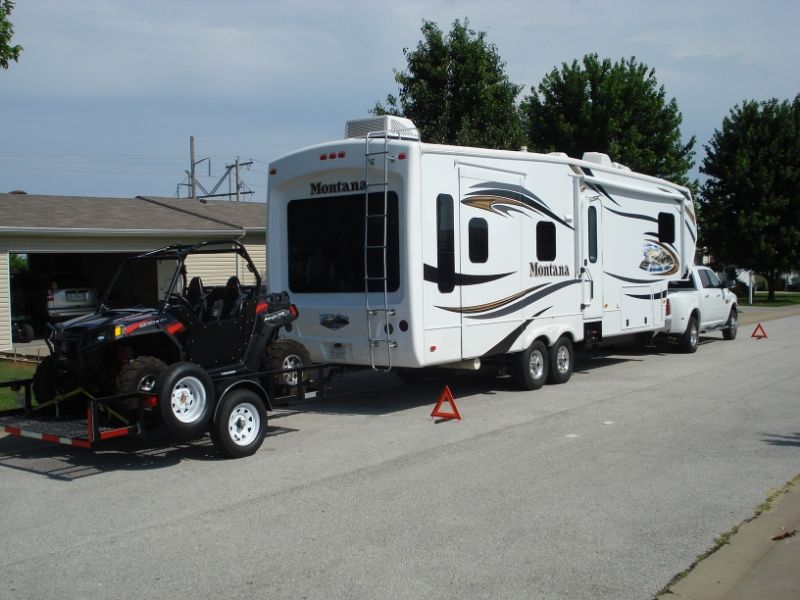

I have a 2012 crew with a 8.5 flatbed on it. put an xp 900 and haul my 24ft.Travel trailer behind it. Went from Billings Mt. to The Oregon coast. It was a little hairy. So I stopped and bought a EQ hitch it helped, But I have since sold the travel trailer and double tow with a 5th wheel. Much better. If I were to have kept the travel trailer I would have put Tembrens or air bags on it and I think it would have been better. Also towed this set up from Mt to south west Utah in march wasn't nearly as bad as Oregon. Oregon roads and speed limits cause a lot of traffic issues compared to Utah.Good luck!

You might go to the RZR forum and ask for input there. I have a 5th wheel and double tow with no issues.
