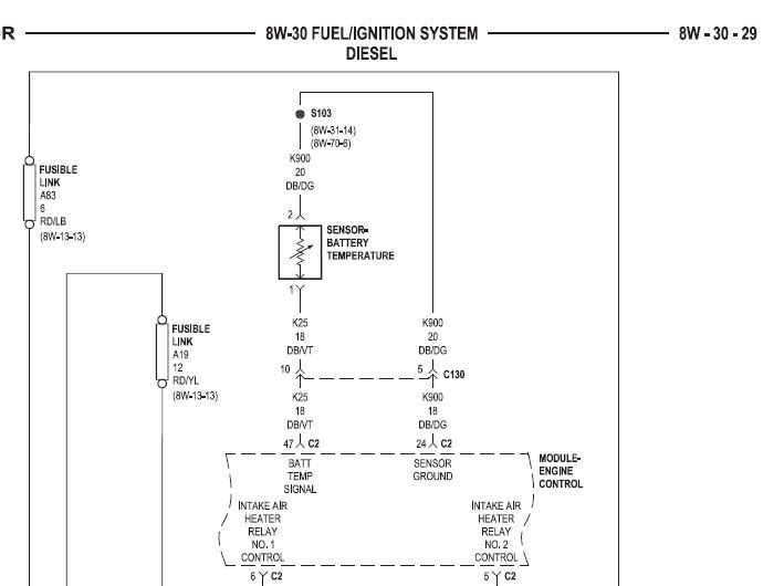

Im doing my cummins conversion and in order to make the 48re work I need to wire in a battery temp sensor. Does anyone know the part number or the location of the sensor or even what it looks like. Here is a schematic of the 2005 and the sensor
213 Posts
The sensor is located underneath the batteries on a 3rd gen truck. All it looks like is a black flat circle anout 1" in diameter with a spring on it.
