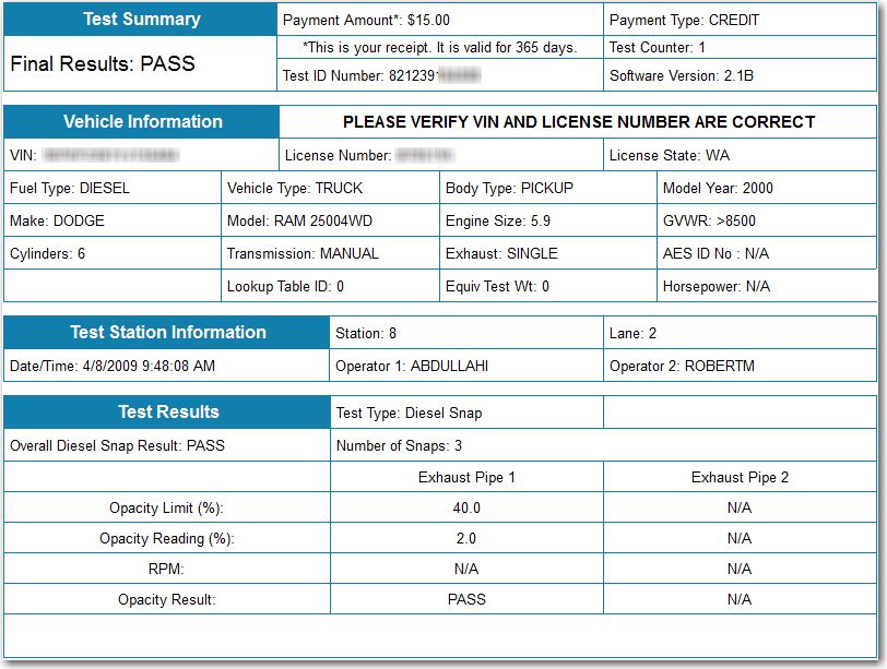

I'm just going by what my last two emissions tests showed:
this was pretty much when the truck was stock:
and this was with twins and DDP150s (my old injectors) with the smarty set to emissions mode (and those injectors hazed at idle)
that is where I got 40% because that is what they held my truck to both years..
