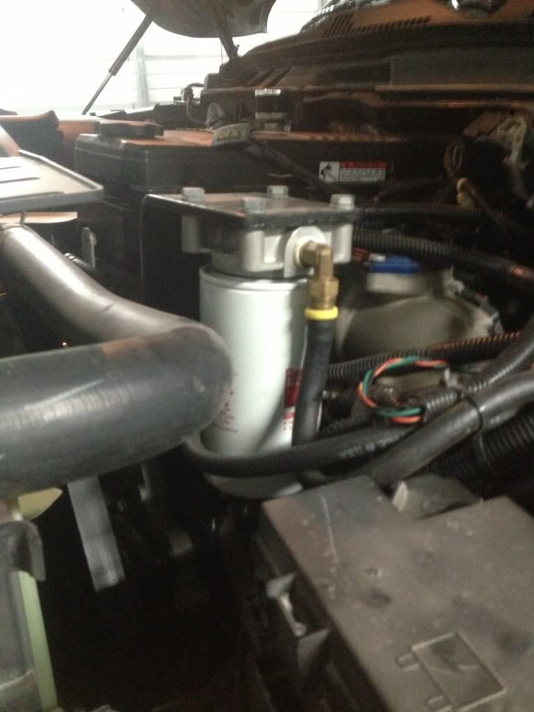

I have one on my truck , it fit perfect and was very easy to install .
how long did it take for the install?
been looking at one for a while and was curious.
I might of had a hour in it .

Yes, you can never go wrong with extra fuel filtration.
GDP kit is top notch and very easy to install, I have one myself and love it.
So what is the priming process after the initial install and then for the following filter changes?
3
I put one on my 12 and one on my friends 09. After learning how to do it on my 12 it probably took 30 minutes tops to put on the 09.
It's very easy and is 100% bolt on. If you decide to get rid of the truck you can take it off and return to stock in about 15 minutes.
It filters after the stock fuel filter and just before the cp3.
Cycle the key a few times. Our common rails are self purging/ priming.
Thats what i thought. I just wanted/needed some confirmation on it for sure! Thanks for the pics guys!

I made up my own setup, bent a 4" by 1/4 " thick flat plate for the mounting bracket and it turned out great. Only got $80 bucks in this setup, less than half what the GDP kit costs.
