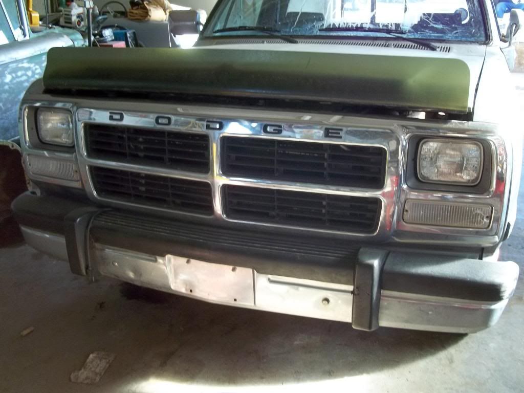

This is what the truck started out as.

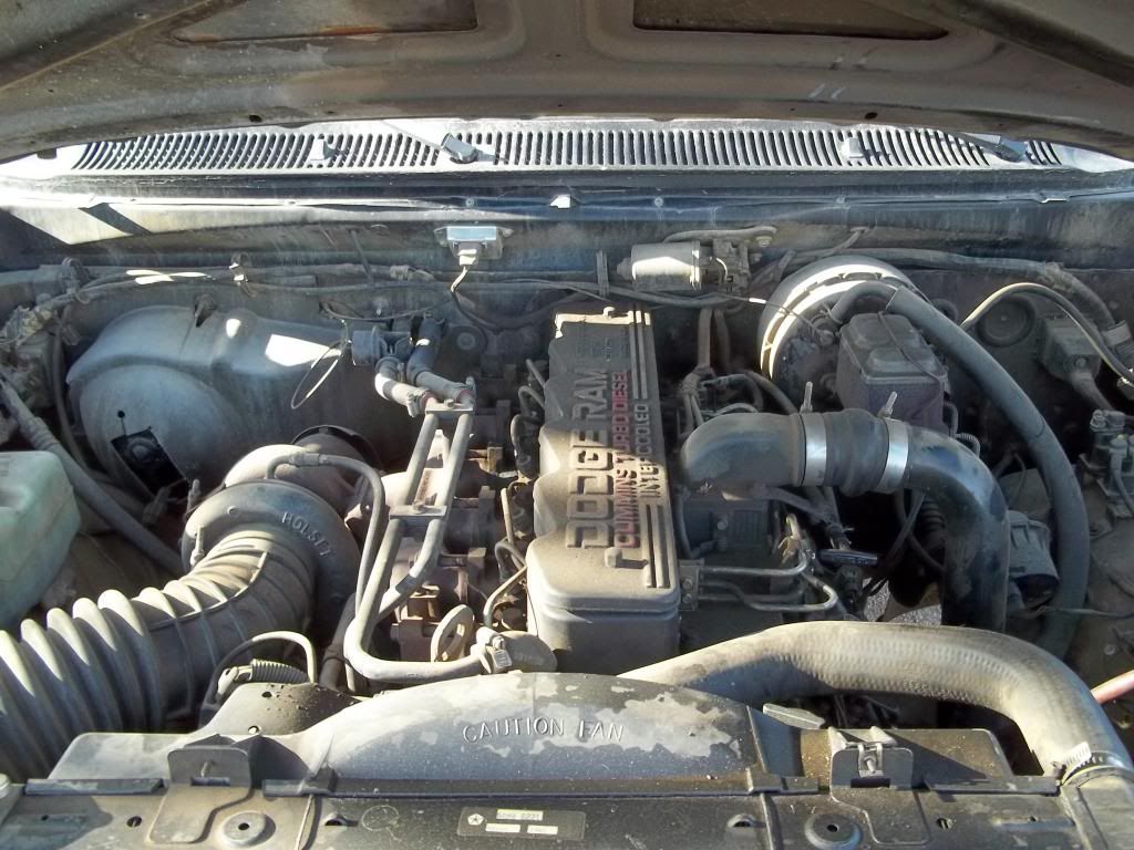

The truck had an oil leak and a little fuel leak. My dad and i had to take the injection pump off and get it resealed which is where the fuel leak was coming from. It was the first injection pump i ever took off a truck so it was a long process. While that was off we were able to also fix the oil leak by putting a new gasket on the pushrod cover. The old one had about a 1/4 inch crack in it. I don't have any pictures from doing all the motor work though.

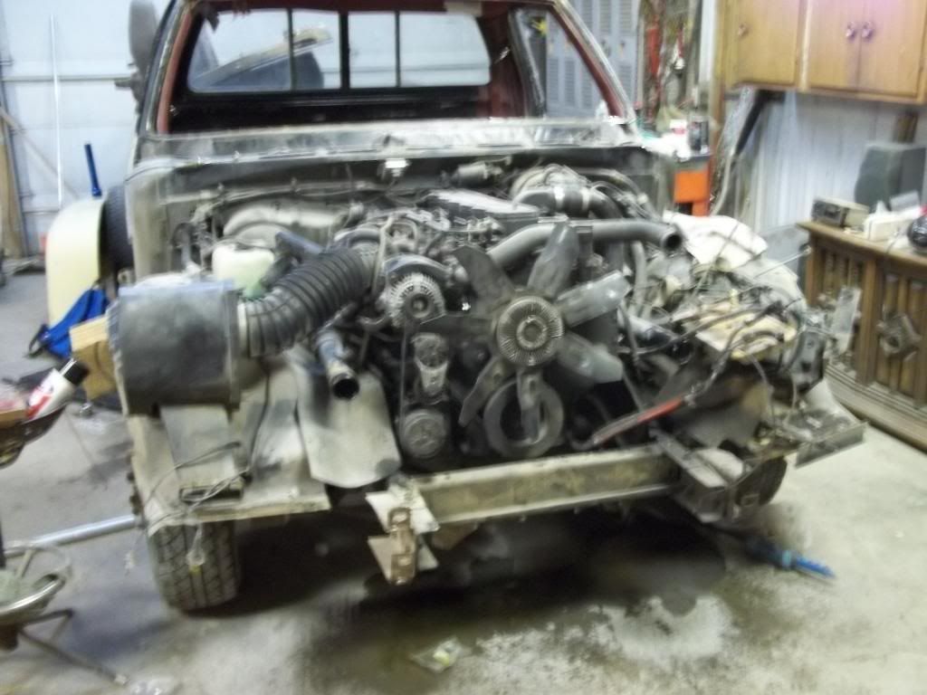

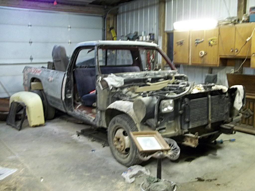

Now i have recently started on the body half of the project and at the moment have it all stripped down.

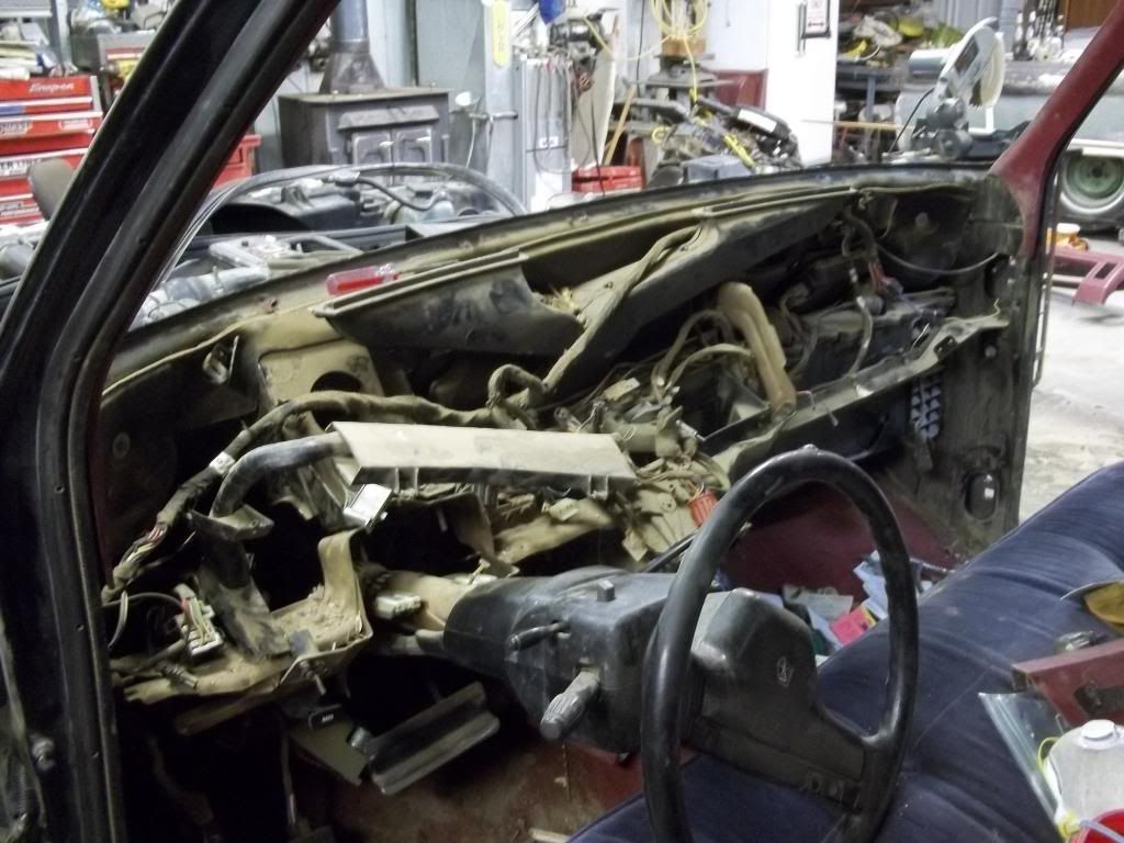

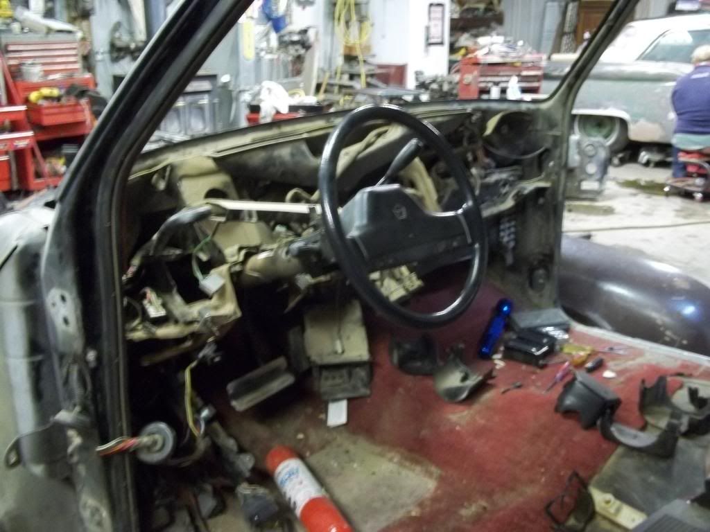

I also took out the dash so that i could paint it and so i could swap the doors on the truck.

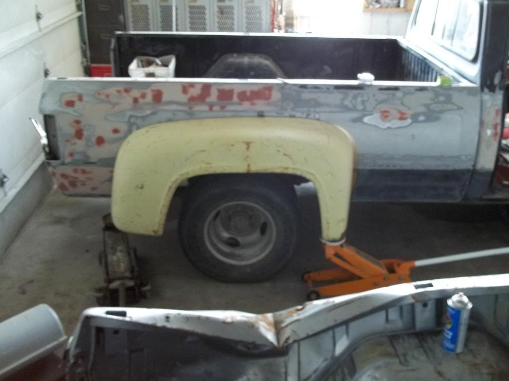

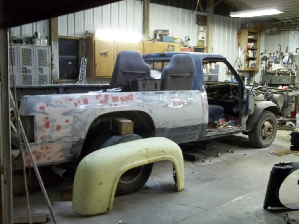

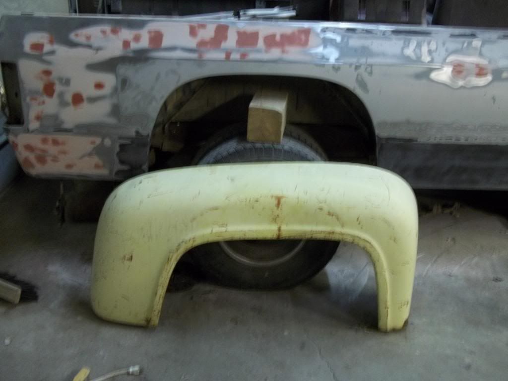

Since 1. i hate fiberglass, 2. one of my fenders was broken, and 3. i like customizing vehicles, i got the great idea from a friend to put rear fenders from a 56 ford truck to cover the outer wheel.
Here is the fender up against the truck to get an idea of what it looks like. When it gets installed the box will be cut to match the fender and the fender will be welded in place.

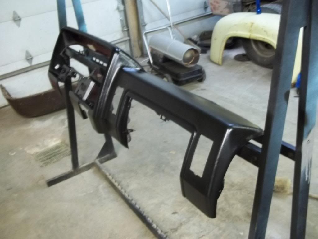

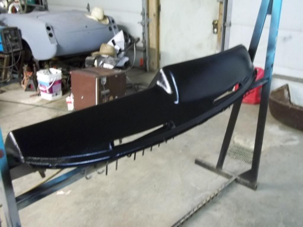

The dash was the stock maroon color which was all faded, and that color won't work too well with the matte black that I'm painting the truck. So i decided to paint it a gloss black to match the gloss black interior of the truck.
Here is the dash with the stock color.
Here it is after i painted it.

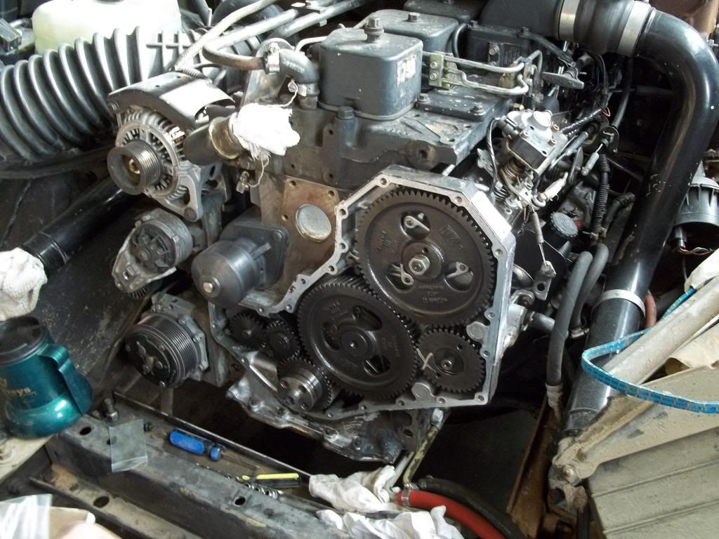

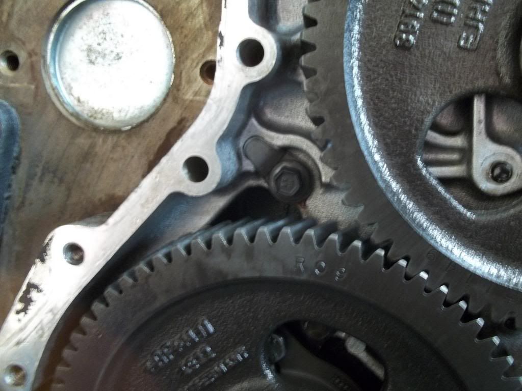

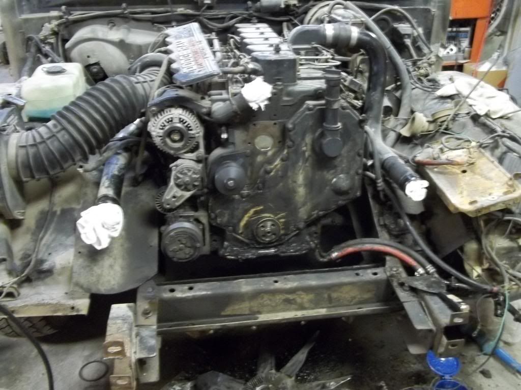

Then i saw the other day a friend of mine, has a 97 dodge that got hit by the killer dowel pin which jogged my memory that i still had to buy a KDP kit. And so i did, and installed it the other day.

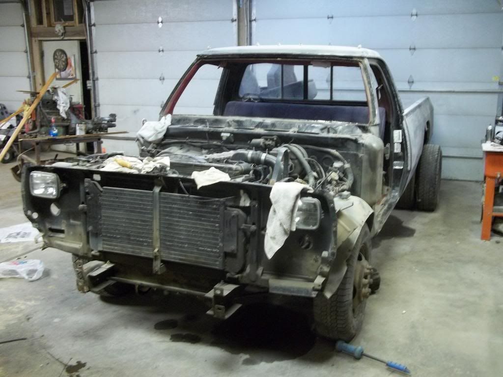

I made it easy on myself since i had the fenders off, i just when and took the whole core support off as well.
Then of course took the fan off and the timing gear cover and ten minutes later had the new bolt and washer installed.
Now with that taken care of its back to the body work, and the best part about that is i have a whole other truck sitting waiting to be stripped out.
My favorite part is the original grille in perfect condition.
Sitting next to the parts truck is the poor old girl waiting for parts.

Then i started cutting out the passengers side of my bed so i can install the fender.
First time ever using a die grinder and pretty happy with the out come.

Got the box cut to resess the fender, now I just have to mount it. I also have to fill in from the bottom of the fender to the bottom of the box.
Also set the new seat in there to mock it up and figure the mounts and holes to drill.
