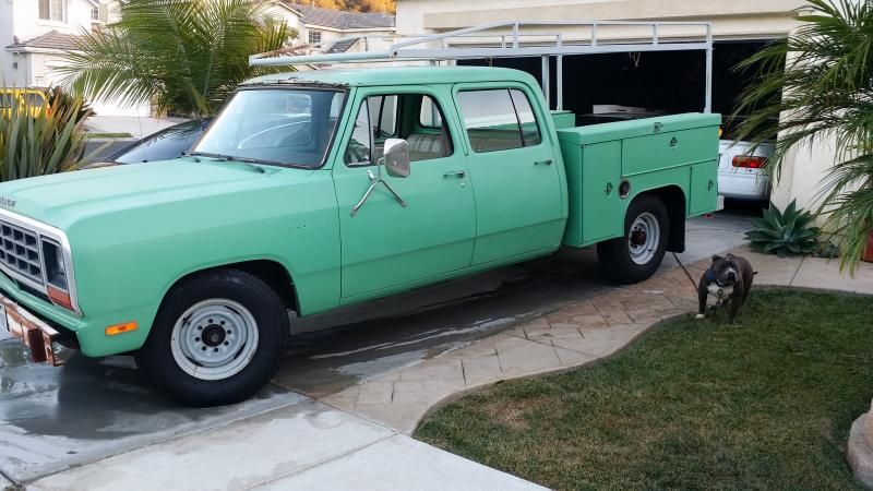

Im looking to lift my crew cab 3in front and rear and run 33s maxx. Whats in there right now im assuming by the looks is from 84. It feels like a Cadillac which im not complaining about but I want to sit a little higher and have a little stiffer feel. Ive been looking on amazon and saw some Moog 7226 coil springs for a decent price and and planned on throwing in 2in spacers and new shocks in the front and using taller blocks and u bolts and new shocks in the rear, Im not sure If im going to keep this truck since it has alot of rust above the windshield so Im trying to do everything on a tight budget so please keep that in mind,heres a picture of my rig.

Well you could do a Body lift or just convert it to 4x4 they are Simple to convert .Not sure if your going to get Much lift with the coil's the back would be easy just add block's but front is going to be the Problem child .
