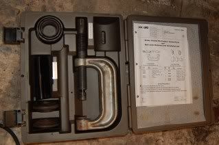

OTC 7249 Ball Joint Press

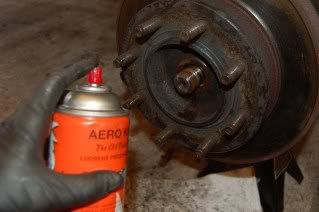

Next, pull the wheels, calipers and cotter pins from the upper ball joints, axle shafts and outer tie-rods. Hang the caliper so as not to have tension on the brake line. Applying penetrating oil on the axle nut, tie-rod end threads and ball joint threads will allow for easy removal later.

Spray the axle shaft splines with penetrating oil.

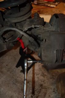

Use the 14mm 12pt socket to remove the knuckle bolts on the back of the knuckle.

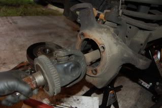

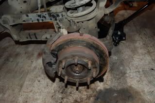

Pop the rotor/bearing off and slide out the axle. The front ales come out pretty easy.

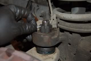

Remove the top ball joint castle nut with the 1 1/8" socket and the lower ball joint lock nut with the 1 5/16" socket. I used a swivel and an impact wrench.

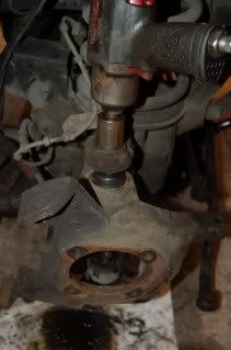

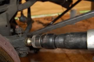

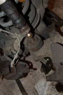

Knock the ball joints loose from the axle. I just used the air hammer, but it will destroy the old ball joints.

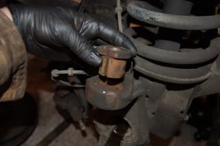

The upper ball joint sleeve may pop out. Some kits come with new ones, but mine didn't. I just reused it.

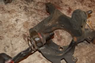

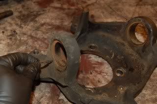

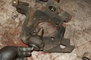

Pull the knuckle off and remove the snap-ring from the lower ball-joint.

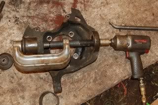

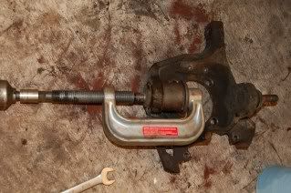

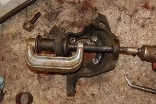

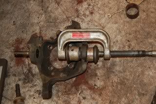

Remove the lower ball joint. Use the ball joint press, and receiver tube. BE SURE TO LUBE THE THREADS ON THE PRESS. I used anti-seize.
Then, remove the upper ball joint. Uppers are easy.
Clean out the ball joint shoulder recesses for proper seating.

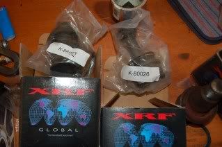

I installed XRF ball joints. XRF Chassis | Automotive and Heavy Duty Chassis Parts | Ball Joints
Remove the rubber boots to prevent damage during install.

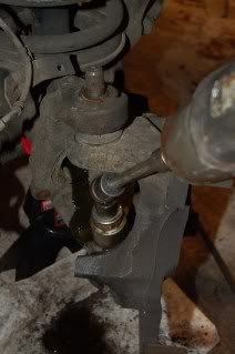

Next, install the lower. I made a installation and receiver tube out of a fence post. OTC as well as many other companies make kits with all kinds of tubes you can use with the OTC press.

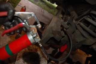

Grease the new ball joints well.

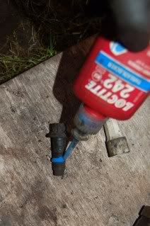

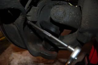

Install the axle (make sure not to get dirt on the splines), and rotor/bearing. This is the hardest part. I used a 1/4" extension to line up the shims, backing plate and holes. It will take some finesse. Use lock tight on the knuckle bolts. Again, no torques. I just reefed them down.
