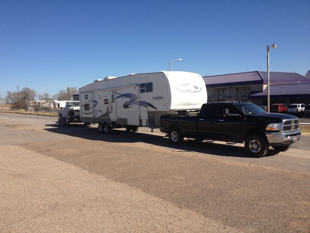

I tow all day long with a 3" system and 37's. Have zero issues and have never came close to the bed rails. I even towed a 43' fifth wheel pulling a 20' car hauler with a 60's ford on it from Cushing, OK to Midland, Texas.
I had some pic's on my phone but I cant seem to find them I will have to see if I can.

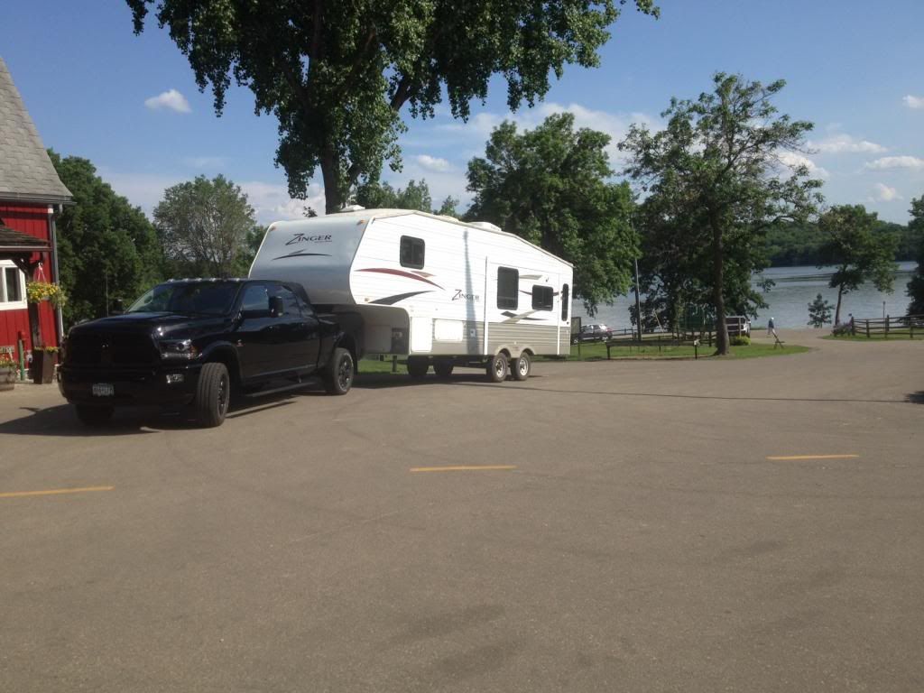

This is with the Carli Mini packs. It squats it pretty good but not horrible. I've pulled this fifth wheel quite a bit with both of my 2012's and the only difference in the 2 is the slt is carli equipped and the Laramie has thuren products.
I've towed a lot heavier as well and had zero issues. I wouldn't hesitate to do it all day long.
hahaha I just noticed I was in the 13 section. I have heard they 13's are a bit higher than previous models but it can't be that much. My 14 will be here in 2 weeks so I guess I will be able to tell.

Woo! I've never seen a car trailer with a truck on it pulled behind a camper, I'm nerve pulling my 3000lb boat!! Is the truck in the pic lifted?
