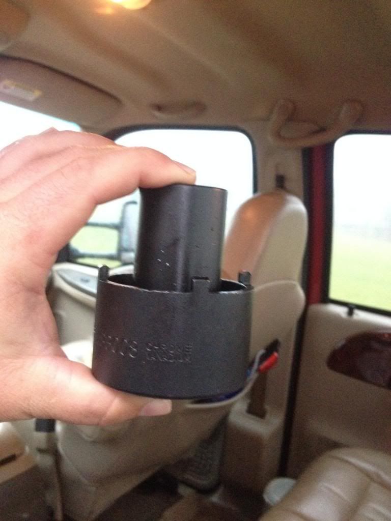

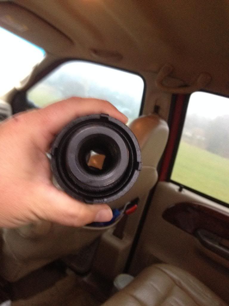

I ran into the same problem with a Ford 3500 w/Dana 80 (pretty sure). Got the socket at O'Reilly's. No size stamped on the side (threw away the package. Had W83008 stamped on the socket, Performance Tool brand. Took a picture and selected one that matched. Worked great. Sorry I can't be more detailed. I'll post a pic in a minute.
Here you go...

Thanks pigrig but it is different then that Auto part Flange Wheel Bearing Locking hubs
Tried looking at any part stores yet? They had several different types at O'Reilly's. Looks like it takes the same category of socket, just different pattern.
I cant remember the exact size but yes it is a special socket. it has rounded edges like this one Sears.com
This might be the exact socket you need but verify size first.
I had to borrow one when i did my axle seal awhile back.
I just got the right one. Rounded edge that napa had 2 9/16.
