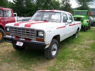

So after buying a few CrewCabs last year, I finally acquired this one:
1981 first year of the Power Ram, W250 w factory Dana60, NV435 4spd, 318cid, 23spline205... And hideous red racing stripes... I think they are what caused the truck to want to go out of service. Oh yeah it's only got 46,000 original miles. All of which were acquired under 55mph.
