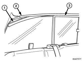

1. Slide the upper run channel (1) out of the window frame (2).
2. Slide the vent glass (3) upward to remove from the lower window frame (2).
3. Lower the glass (3) out of the upper window frame (2) and remove.
searching around google i didn't find much info about installing the glass. This info pictured was about the best i found. I wanted to elaborate a little on the steps and put others at ease on how easy it really was to replace.

Step two: using same pick or in my case pocket knife pull upper window track out of upper window frame towards pass side. Its plastic, its c shaped, and will come out of the frame when collapsed on one side #1 in pic

step four: place upper window channel into upper window frame sliding towards Dr side. Make sure when window channel gets to the edge of the new glass it goes into the center of the window channel. keep pushing towards the Dr side until you can push the pass side back channel into the top window frame where it sits flush.
yes the pic is non power slider.
