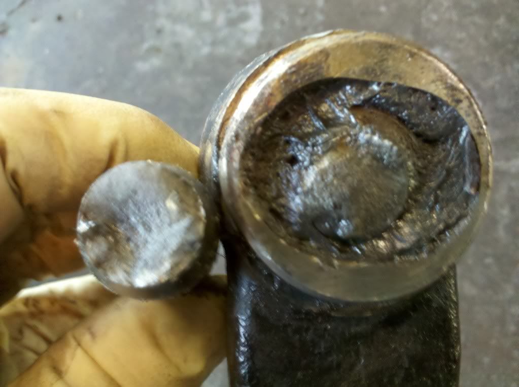

here is one, you can see all the way to the left on the socket where it is worn.
Better with all the grease removed.... you can see here that he housing isn't even round any more. Almost like it was binding, which could have exacerbated the load already on the joint contributing to breakage.
