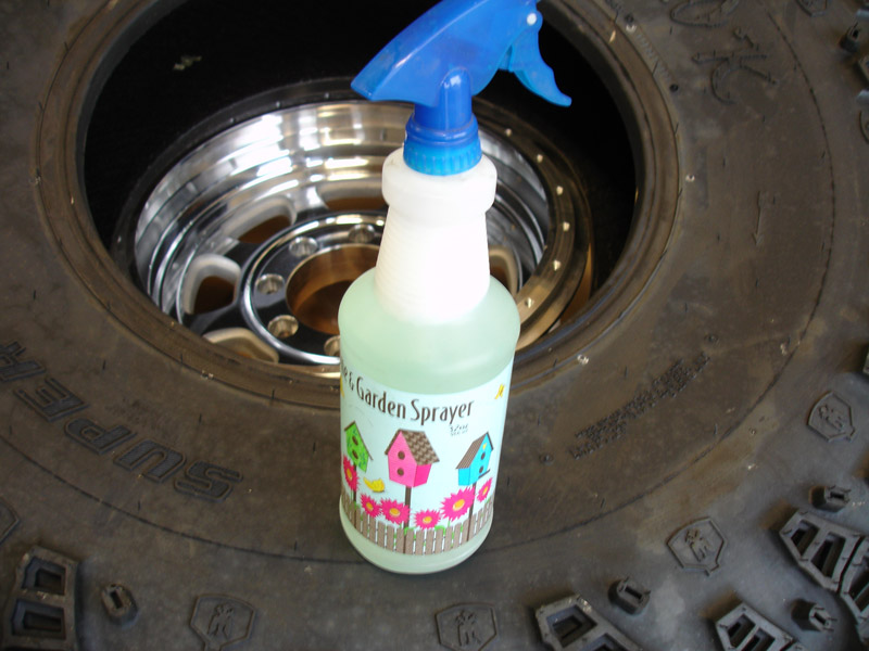

My current wheels are very similar to the walker evans bead locks. They are both forged aluminum. Both have a bead retention lip. Both have a bolt on outer ring securing the bead to the wheel. I have a buddy with a set of WE bead locks. I checked torque on my bolts 1 time after install at about 100 miles. Then again at 500 miles. No change. Same with the WE on my buddies rig.
You can see the bolt holes here.
mounting the tire in my garage.
then sit back and let your wife do the rest of the work. LOL
