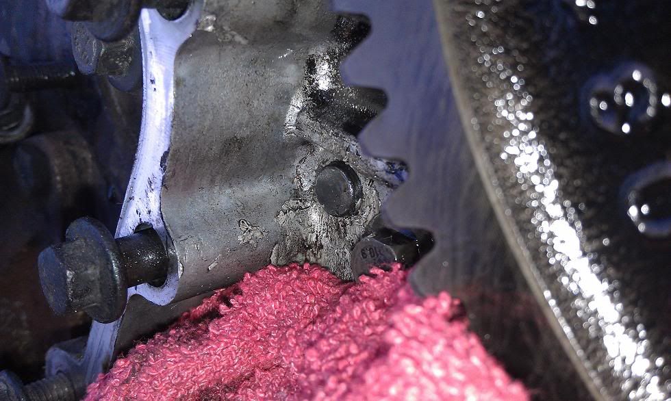

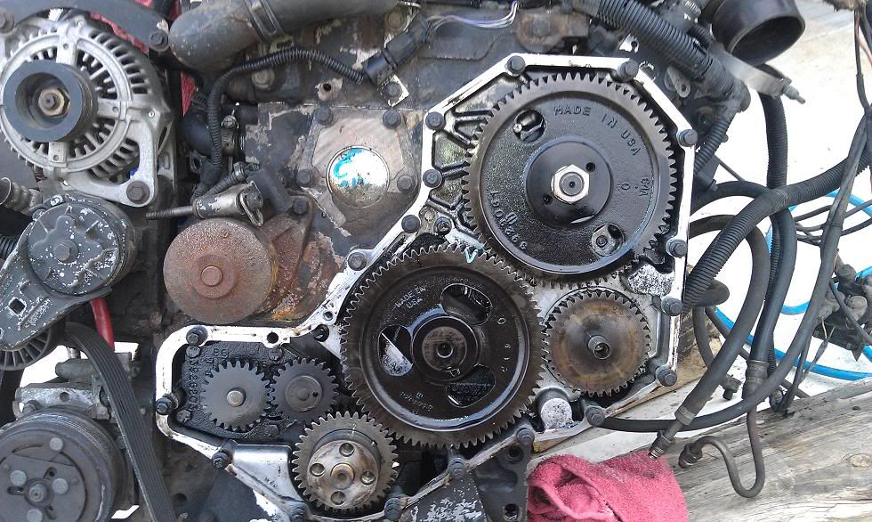

So this weekend i had some spare time, decided to look to see if there had been a KDP repair on the engine, I didnt see the case cracked along the housing, I feel lucky after this find...
Someone had been in the case, cause there was alittle silicone on the DP?
Almost ready to come out, felt good to see it still in there tho
I was looking at the kits online for the KPD repair, i decided to make my own tab, and went to lowes bought a longer bolt, added a splash of thread locker and went to Kragen and ordered a timing case gasket kit 30.00

The 12V is ready to go! i got the gasket set, and installed it thursday evening. The crank shaft seal that was in the case was a bit challenging to remove, it was the original one. Installing the new crank shaft seal was fun..lol finally got it all back together with new crank case seal. Also installed a new water pump too.
