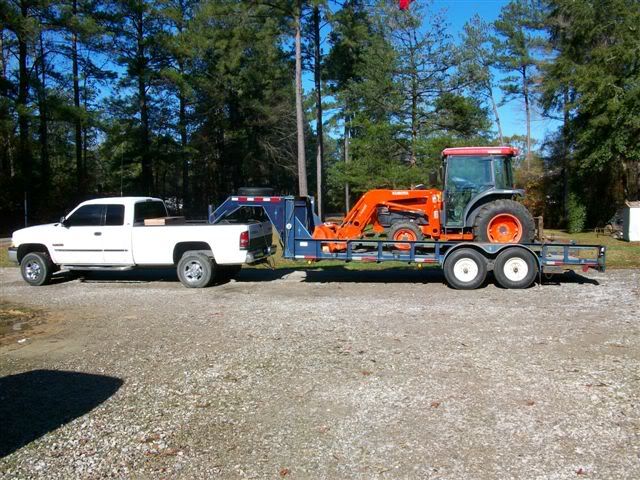

2000 extended cab 4x4, automatic trans built (no billet), ats valve body, ats 5 star converter, BHAF, straight pipe, no silencer ring, 3.55 gears, Coaltrain 150 injectors with some lift...some, Edge EZ, 265/70/17 tires. PYRO IS PRE TURBO! Isspro gauge EV1 is what it is
the truck has a tool box in the back that is loaded (350lbs). goose neck plate is in. there is a load of fire wood in the back (not much.....175lbs). also about another 100lbs of scrap metal in the back. this is not much at all but it's just a list for people that beat dead horses.
same set up but with a tractor behind me (50hp Kubota 4x4 with a front loader). this time i was sitting still at a red light and gave it heavy acceleration (3/4 throttle maybe a tad more). egt's settle around 900* under normal conditions with the converter in lock up (no lock up switch). driving conditions 55-65 mph.
this is the same weight (tractor) but going up a pretty steep grade. video is kinda dark but you can see the end result. same throttle from a dead stop.
picture of the truck loaded when the video was shot
