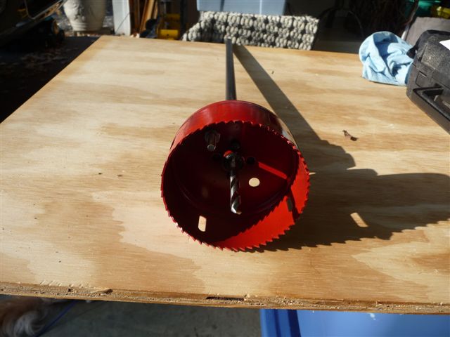

Thanks D2B, what I am doing is removing the DPF and then putting a 3 and 3/4 hole saw through it. Looks like I can do the deed right on the truck with the NOX cannister. I got a 7/16 drive and a nice 18 inch quick connect extension for the hole saw. Everything will be in place, just disconnected in a stealthy manner.

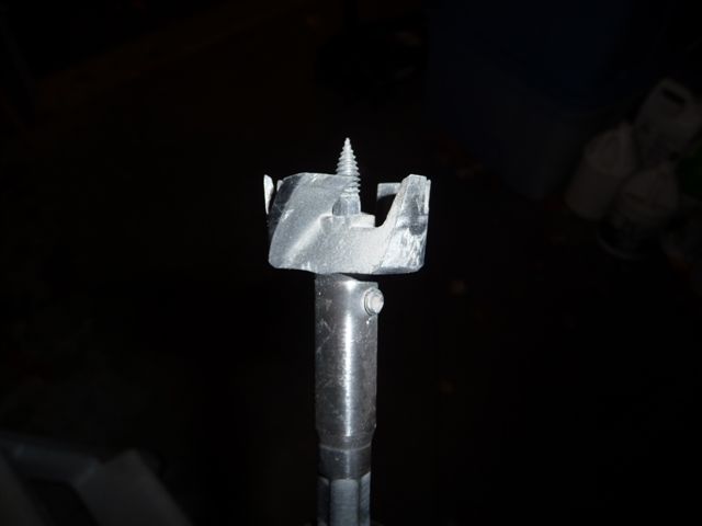

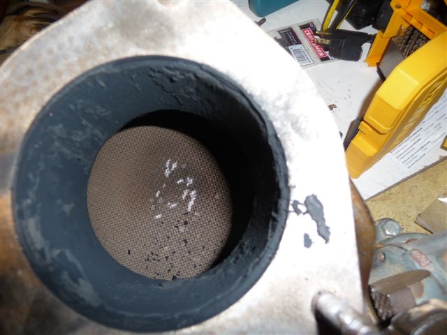

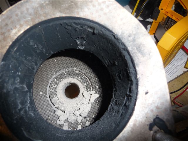

The NOX was a piece of cake because the hole saw fit right in. I also bought this wild looking self feeding drill in 1 1/2 inch. I started the hole saw to get a nice round slot. Then I drilled the center all the way through with the 1 and 1/2 incher and using a long screwdriver and a hammer knocked chunks out, sawed some more and in three passes was all the way through.

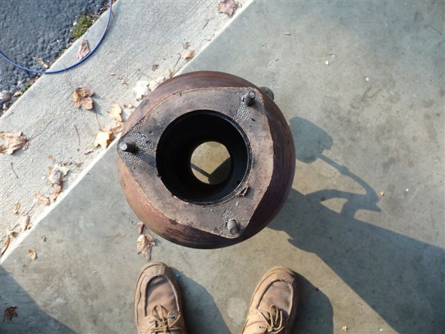

The DPF was not so clean. There are ports in the way of the hole saws. So, the 1 and 1/2 incher all around and then knocked out the middle. Worked just fine but is a bit more rough on the inside.

Here is the hole saw, auto feed saw, NOX and DPF along with a pile of absolutely useless junk.

i've never seen the inside of the DPF How in the hell does anything make it out of the exhaust? Also I love the the hole right through the middle of $2000 I just wish I could have been there when you did it. Awesome!
