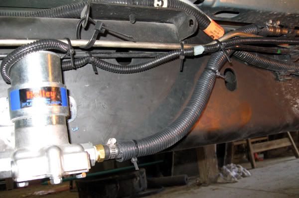

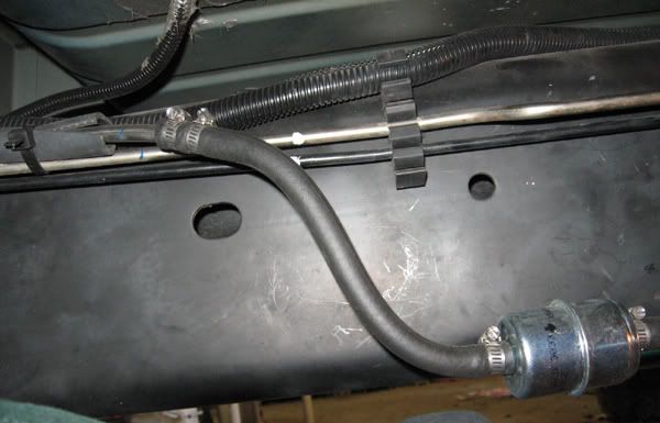

I installed the Holley Blue about a month ago. I just got around to taking a few pictures of it. Here are a few pictures of my Holley Blue installed. Works Great!

but low on the frame isnt it?
i would fab a box for it and mount it around the pump.

The Holley is a pusher pump. So it needs to be back by the fuel tank. The picture makes it look low but is flush maybe a tad higher then the frame.....

My stock pump is still inline and working also. The Holley Blue is being used as a pusher pump to my stock lift pump. The flow rate for the Holley is 110ghp at 14psi. I built a Cat-2 fuel filter system for my truck and wanted a little extra fuel psi. I went with the Holley Blue because it only cost $99.00 compared to other fuel pumps that run $300.00 plus. Now I'm running at 22 psi at idle compared to the 8 psi the stock lift pump was pushing.....
